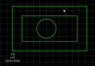

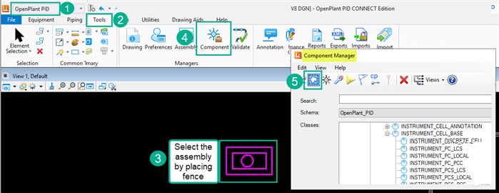

  2. From drawing, place a desired graphics with the help of placement tools as shown

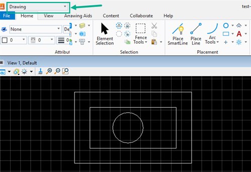

  3. Change the workflow to OpenPlant PID, select the graphics & click on create component from element as shown
  4. A build new component dialogue will now pop up on the window. Enter the new class name, select the base class & click on Next. Refer the attached image below

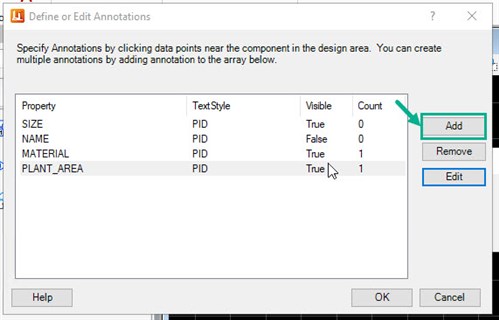

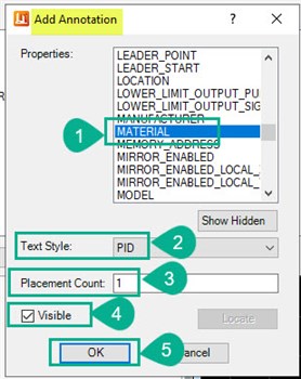

  6. Now add the required annotation for the component with the help of “Add” option as shown
    For example:
    upon clicking on add, a new Add annotation tab will open. Select any property, text style, placement count & hit on ok as shown

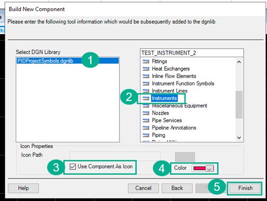

  7. Now the DGN Library will be selected. Click on instruments class, check on the box if a component is to be used as an icon, change the color if required & click on finish.

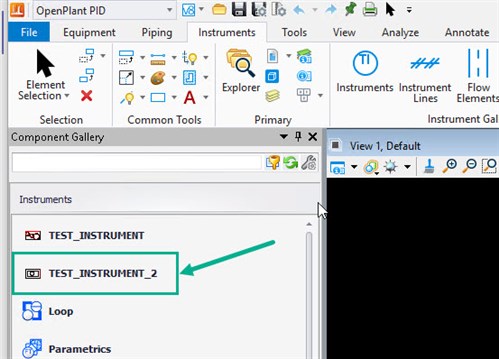

  8. Notice that the new instrument is now added in the list

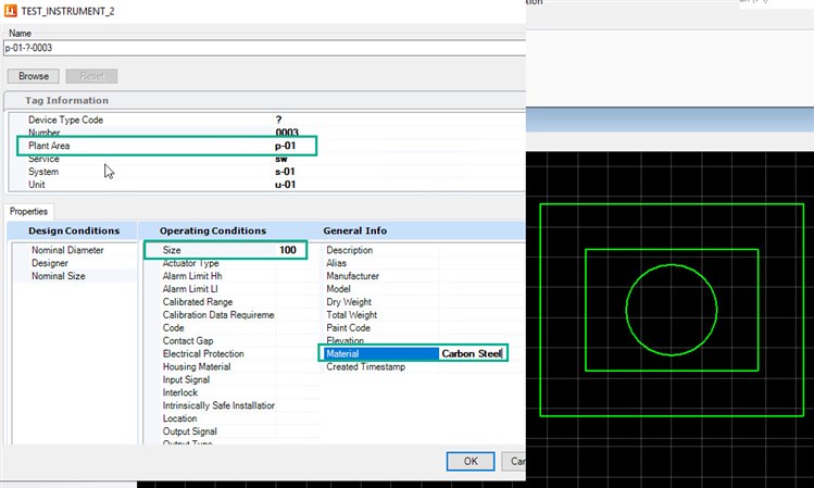

  9. Click on the created instrument, enter the fields to annotate as selected in step-6.
  10. Once done, notice that the component is placed with the desired annotations as shown
