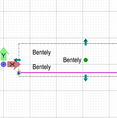

The text become hollow in Drawing and Sheet view. But in 3D Model view it looked how it should be.
 Version(s):CONNECT Edition
 Area:General
This is a common issue faced by users. They place bold text in a 3D Model but after that when they place a callout and create a drawing and sheet view the text becomes hollow.
In 3D view,
In the Drawing view,
To solve this issue you need to follow the steps written below,
1. Go to the reference dialog of either the Drawing view or the Sheet view.
2. Change the visible age from Cached to Dynamic. And then the text will look the same as the 3D view.
