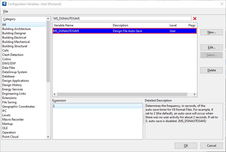

  1. From the backstage choose File > Settings > ConfigurationConfiguration Variables:
  2. Search for the configuration variable: MS_DGNAUTOSAVE
            Now define the value as desired, which determines the save frequency in seconds. For example, if set to 2 (default) an auto-save will occur when there is no user activity for about 2 seconds.
Note(s):

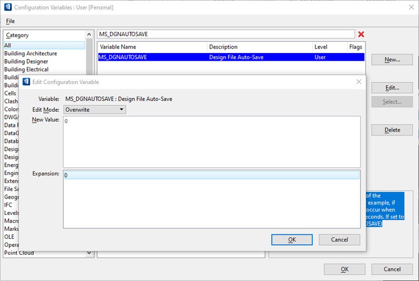

For disabling the Auto-save one can follow any of the below options:
Option 1:
If the variable MS_DGNAUTOSAVE set to 0, auto-save will be disabled.

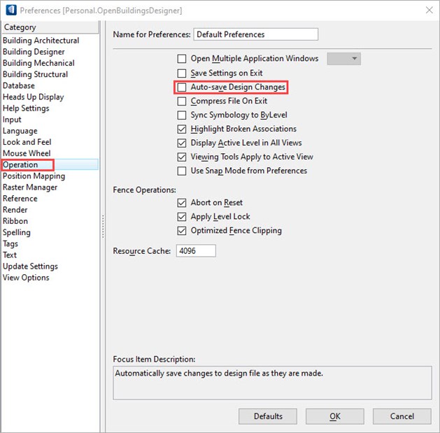

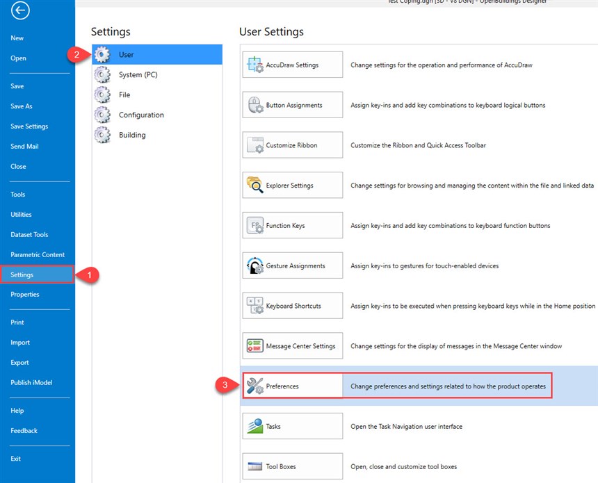

Option 2:
1. From backstage choose Settings > User > Preferences:
2. From the Operation category un-check Auto-save Design Changes - auto-save will be disabled.
