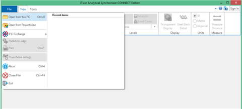

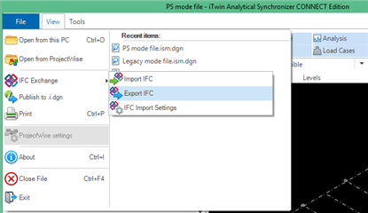

1. Open the ISM file exported from OpenBuildings Designer CONNECT Edition using iTwin Analytical Synchronizer
2. Choose File > IFC Exchange > Export IFC

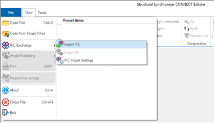

3. Open Structural Synchronizer v11 and choose File > IFC Exchange > Import IFC

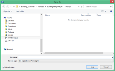

4. Browse to the file created in step 1 above, click OK, then in the pop-up dialog and choose a location where to save the IFC > ISM exchange results
This process bypasses the differences between iTwin Analytical Synchronizer and Structural Synchronizer. Note that the structural ECS axis data may not make it across intact using IFC exchange, but this is something you should be able to correct after the fact.

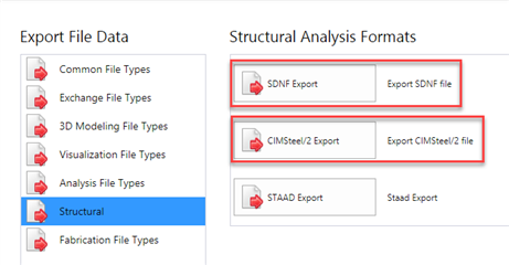

Use an intermediate structural format:
1. With your structural DGN file open in OpenBuildings Designer, choose File > Export > Structural
2. Choose either SDNF Export or CIMSteel/2 Export
3. Open a DGN file usng AECOsim Building Designer V8i
4. From the Structural Import/Export task group choose either Import CIS/2 File or Import SDNF File
