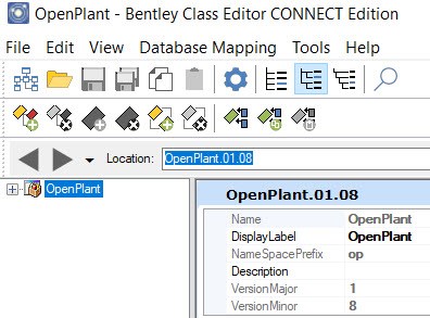

  4. Load Bentley Class Editor.
  5. Open OpenPlant.01.08.ecschema from desired workset. Refer image below.
  6. Supplement it with OpenPlant_Supplemental_Tagging.01.08.ecschema from workset location.

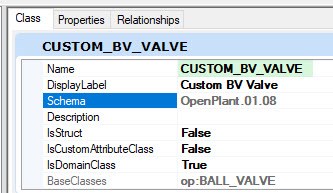

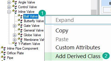

  7. Navigate to BALL_VALVE class, right click on it & select Add Derived Class, refer image below.
  8. Enter same class name as CUSTOM_BV_VALVE (the one that we created in OpenPlant PID using Custom Component tool), refer image below.
  9. Save all the schema changes.

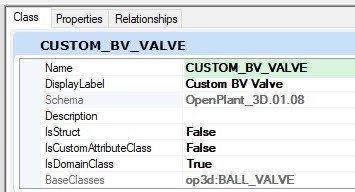

  10. Open OpenPlant_3D.01.08 ecschema & supplement it with OpenPlant_3D_Supplemental_Modeling.01.08.ecschema.
  11. Perform the same steps mentioned in step 7 & 8 above. Refer below image for reference.

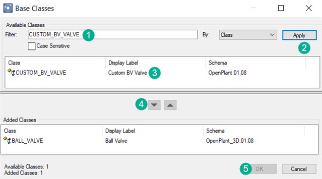

  12. Right click on Custom BV Valve & select Base Classes as shown below.
  13. Under Base Classes dialog, enter class name as CUSTOM_BV_VALVE & follow the sequential steps mentioned below.
  14. Save all the schema changes & close Bentley Class Editor.
