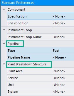

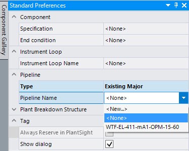

In OpenPlant PID CONNECT Edition, to define a new pipeline we need to enter details (Plant Breakdown Structures & Properties) under Plant Breakdown Structure & Pipeline section of Standard Preference dialog, refer image below.

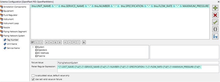

  1. Defined line number format/name must match as per defined EC Expression.
  2. Correct parser expression must be available to exactly parse the line number (tag name)

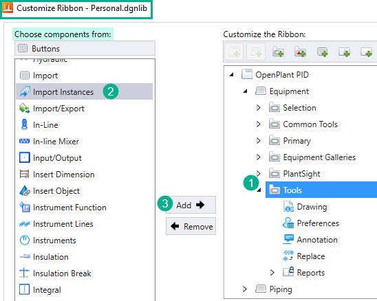

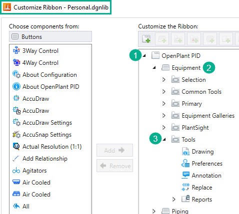

  3. Right click on white-space of a group & select Customize Ribbon
  4. From Customize Ribbon dialog, under Customize the Ribbon section, expand OpenPlantPID > Equipment > Tools. Refer image below.
  5. From Choose Components from section, search for Import Instances.
  6. Select Tools > Import Instances > Add. Refer below sequential steps.

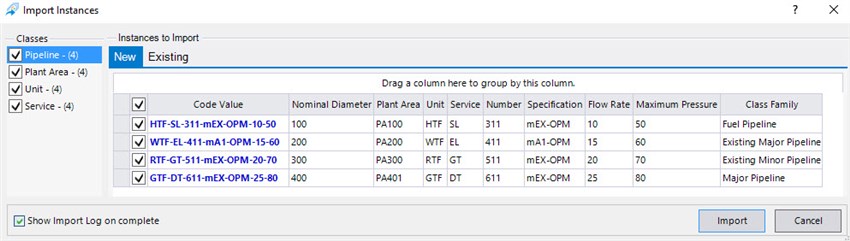

  10. Select the desired database file (here *.xlsx file) & click on Open
  11. Notice that records from excel file shows in Import Instances dialog, refer image below
  12. Click on Import.

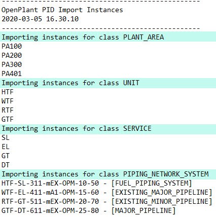

  13. Notice that in log file import status shows as shown below.
  14. From Standard Preference dialog, change the pipeline Type to see the imported pipeline, refer image below.
