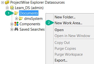

  3. Right click on Documents & select New Work Area to create configuration folder.

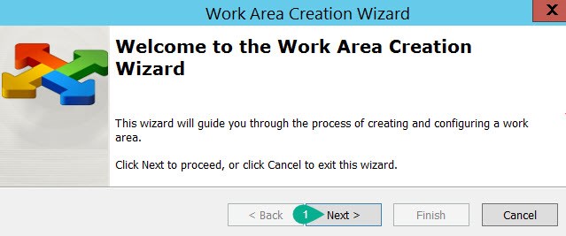

  4. Under Work Area Creation Wizard dialog, click on Next. Refer image below

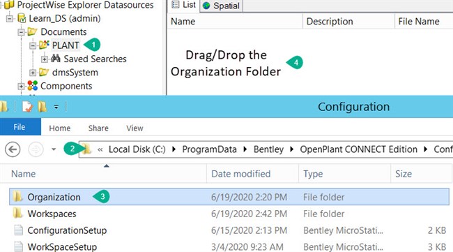

  8. Navigate to your local configuration, drag/drop Organization folder to ProjectWise created configuration folder. Refer image as shown below.

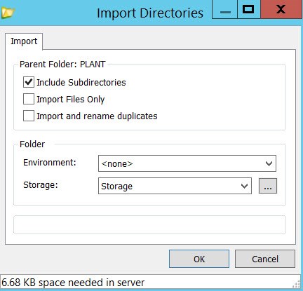

  9. This will prompt to Import Directories Check on Include Subdirectories, select OK to proceed. Refer image as shown below.

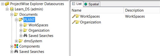

  10. From ProjectWise Client, select PLANT (configuration level), right click & create a New Folder with name
  11. Once done, folder structure will look like as shown below.

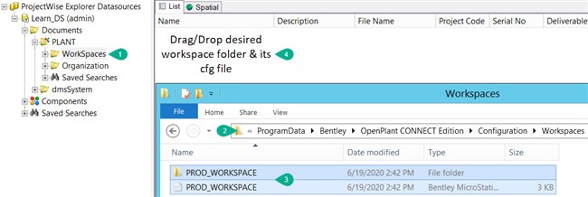

  12. Next task is to place the desired workspace inside created WorkSpaces folder.
  13. Select the WorkSpaces node. From local directory, select desired workspace along with its cfg file & drag it inside WorkSpaces (WorkSpaces level). Refer image as shown below.
  14. This will prompt to Import Directories dialog. Check on Include Subdirectories, select OK to proceed. Refer image as shown below.
