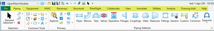

In OpenPlant Modeler CE, requirement is to see all the OpenPlant Support Engineering tools. By default, there are only limited ribbons available as shown
This wiki article explains how to do add the OPSE tools on OPM interface.

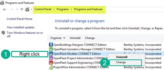

  2. From Start, launch Control Panel.
  3. Open Programs > Programs & Features.
  4. From the list of all installed applications, right click on OpenPlant Modeler & click on change

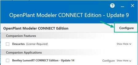

  5. The configuration dialogue will now evoke on the screen. Click on configure as shown
  6. Check on the option for OpenPlant Support Engineering & click on done as shown

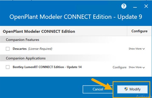

  7. Click on Modify as shown

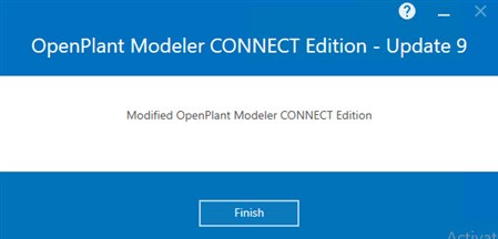

  8. Click on finish once done.

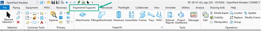

  9. Launch OpenPlant Modeler CONNECT Edition.
  10. Launch OpenPlant Modeler CONNECT Edition.
