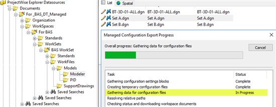

Using OpenPlant Modeler managed workspace upon opening a document with MicroStation, it struck at Gathering data for configuration files. Refer image as shown below.
In this wiki article, we will explore about the recommended changes that are required to allow OpenPlant Modeler managed workspace to load a document using MicroStation application.

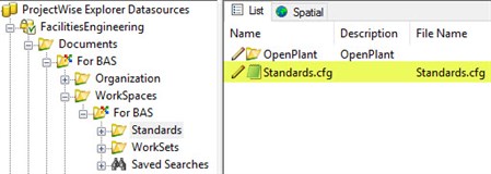

  1. Load ProjectWise Explorer and login to datasource
  2. Changes are required at workspace and workset level for standard.cfg file.
  3. Login to datasource and expand workspace. Select Standards.cfg and open it in notepad or notepad++.
  4. Modify the variable as shown below.
    %if defined (_USTN_PRODUCT_DIR_NAME)
    %if exists ($(_USTN_WORKSPACESTANDARDS)$(_USTN_PRODUCT_DIR_NAME)/*.cfg)
    %include $(_USTN_WORKSPACESTANDARDS)$(_USTN_PRODUCT_DIR_NAME)/*.cfg level Workspace
    %endif
    %endif
  5. Save the changes and check-in the document file.

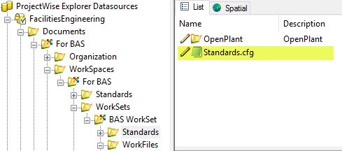

  6. Similarly, navigate to Standards.cfg from workset level, refer image as shown below.
  7. Select Standards.cfg and open it in notepad or notepad++.
  8. Modify the variable as shown below.
    %if exists ($(_USTN_WORKSETSTANDARDS)$(_USTN_PRODUCT_DIR_NAME)/*.cfg)
    %include $(_USTN_WORKSETSTANDARDS)$(_USTN_PRODUCT_DIR_NAME)/*.cfg level Workset
    %endif
    %endif
  9. Save the changes and check-in the document file. Try loading document with MicroStation CONNECT.
  10. Notice that it load the document successfully.
