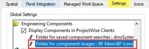

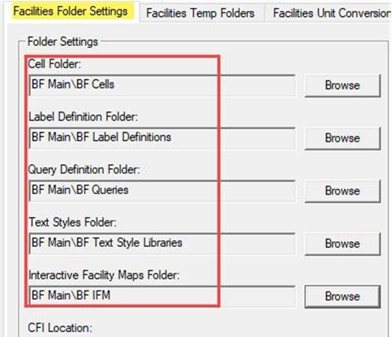

In Bentley Facilities Planner Admin - Modify Data source properties by setting the correct Bentley Facilities main Folders.
- In Facilities Folder Settings tab > BF Cells, BF Queries and other
- In Settings tab > Images pointing to BF Icons
