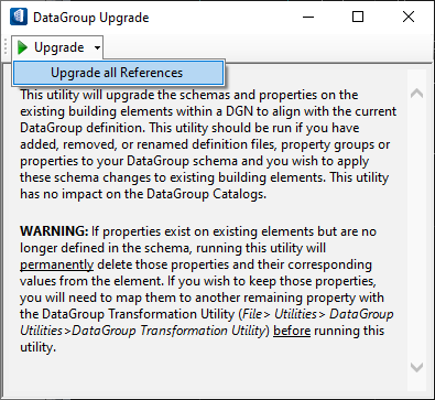

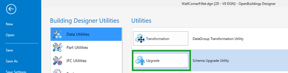

CONNECT Edition - File > Utilities > Data Utilities > Upgrade (Schema Upgrade Utility)
V8i - Utilities menu > Building Designer Utilities > DataGroup Upgrade Utility > Upgrade.

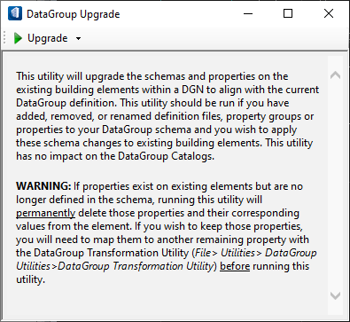

Important: note that if properties exist on existing elements that are no longer defined in the schema, running this utility permanently deletes those properties and their corresponding values from the elements. If you wish to keep those properties, you must map them to another remaining property with the DataGroup Transformation Utility, before running the DataGroup Upgrade Utility.
The utility is also available via key-in:
mdl load Bentley.Building.Datagroup.Upgrade; dg upgrade

The following sequence should ideally be used when none of the referenced files are in use so all files can be processed. File that are not processed will be listed so can be upgraded individually or by a repeat run.
This will process all of the attached files. The time required for this to complete will vary according to project size and complexity. For larger projects it may be appropriate to work with sequential groups of files rather than attaching all files.
