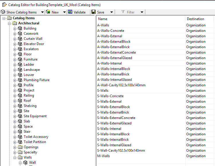

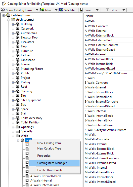

To start, right-click on the Catalog Type and pick Catalog Item Manager:
Note that the Catalog Type is listed as 'Wall', items can only be moved around within the same Catalog Type as the underlying schema must match in all locations.

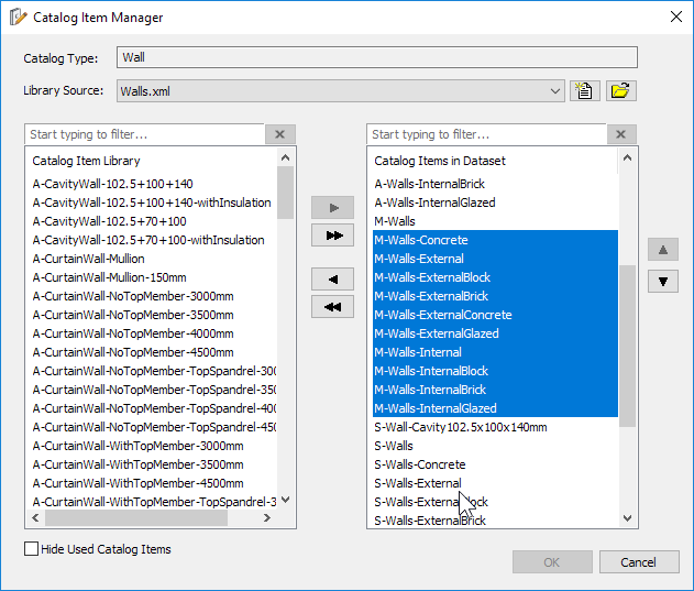

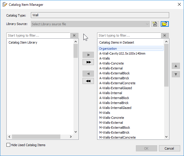

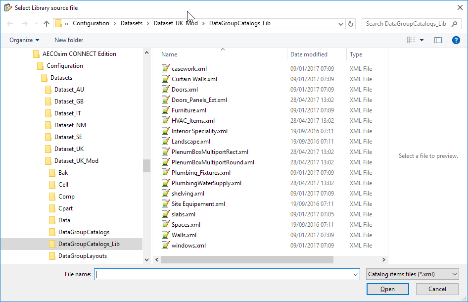

Browse to select the Library Source File. In this dataset there are a number of existing library files as we have moved some existing content into the library to slim down the default content presented to the UI. Pick Walls.xml:

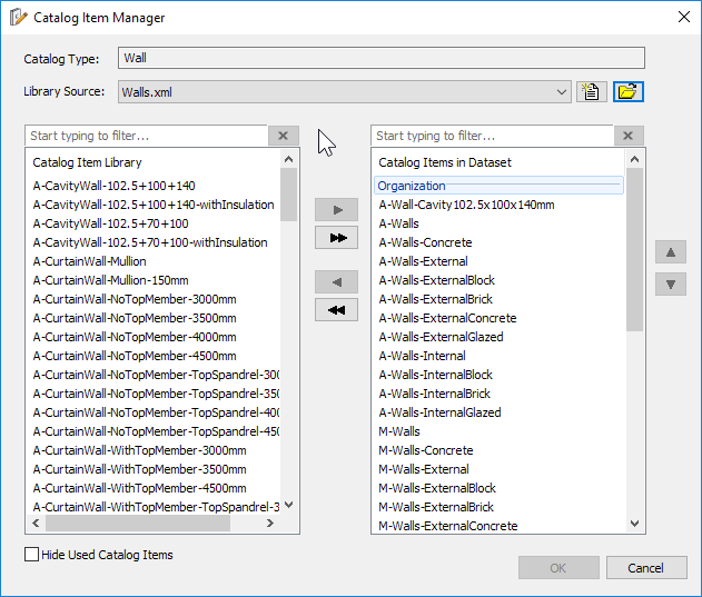

Note that the Library content is now listed in the left-hand panel:
To Move the Mecahical wall variations to the library select them in the right-hand panel:

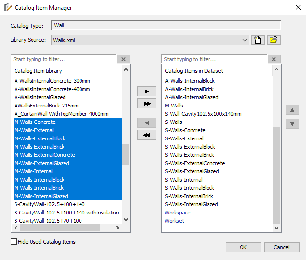

Click the (single) leftward arrow to move them to the library, click OK to finish:
Note the reduced list, only one generic Mechanical wall remains:

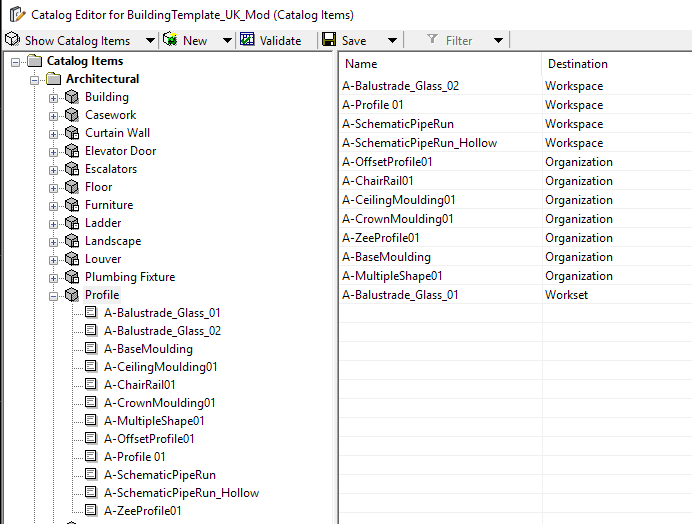

A similar process can be used to move content form one configuration level to another. Listed below are a number of user defined profiles and their locations. The profiles delivered with the dataset are in the Organization. Custom  profiles are in the WorkSpace and WorkSet:

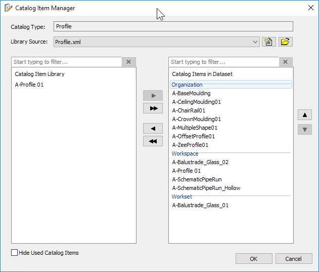

Opening the Catalog Item Manager the items are listed under those levels:

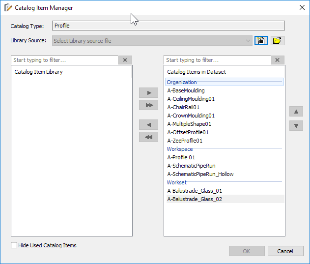

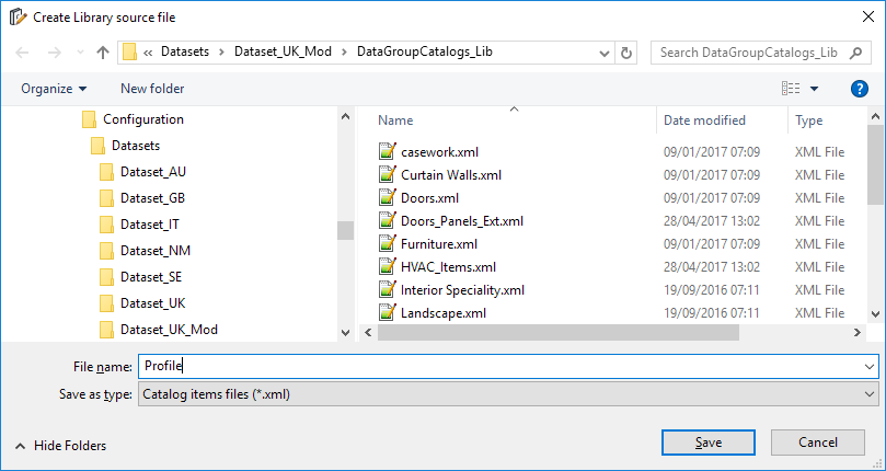

In this case there is no existing library file, so create a new file, Profile.xml:
Shown below are two moves:
1. A-Profile 01 has been moved to the library and is stored in the new Profile.xml file
2. A-Balustrade_Glass_02 has been moved to the WorkSpace and is stored in the existing Catalog xml file contained in the WorkSet
