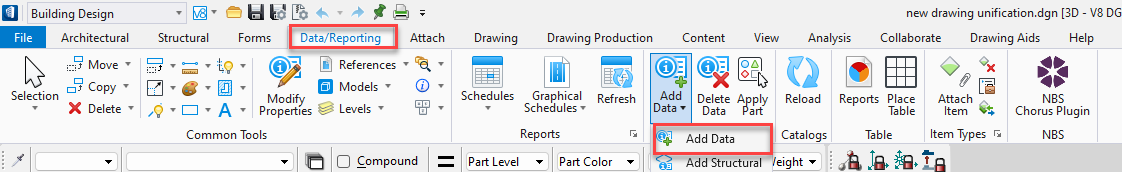

The "Add Data" tool can be selected from the "Data/Reporting"  tab > Add Data tool group, then applied to the selected element(s).

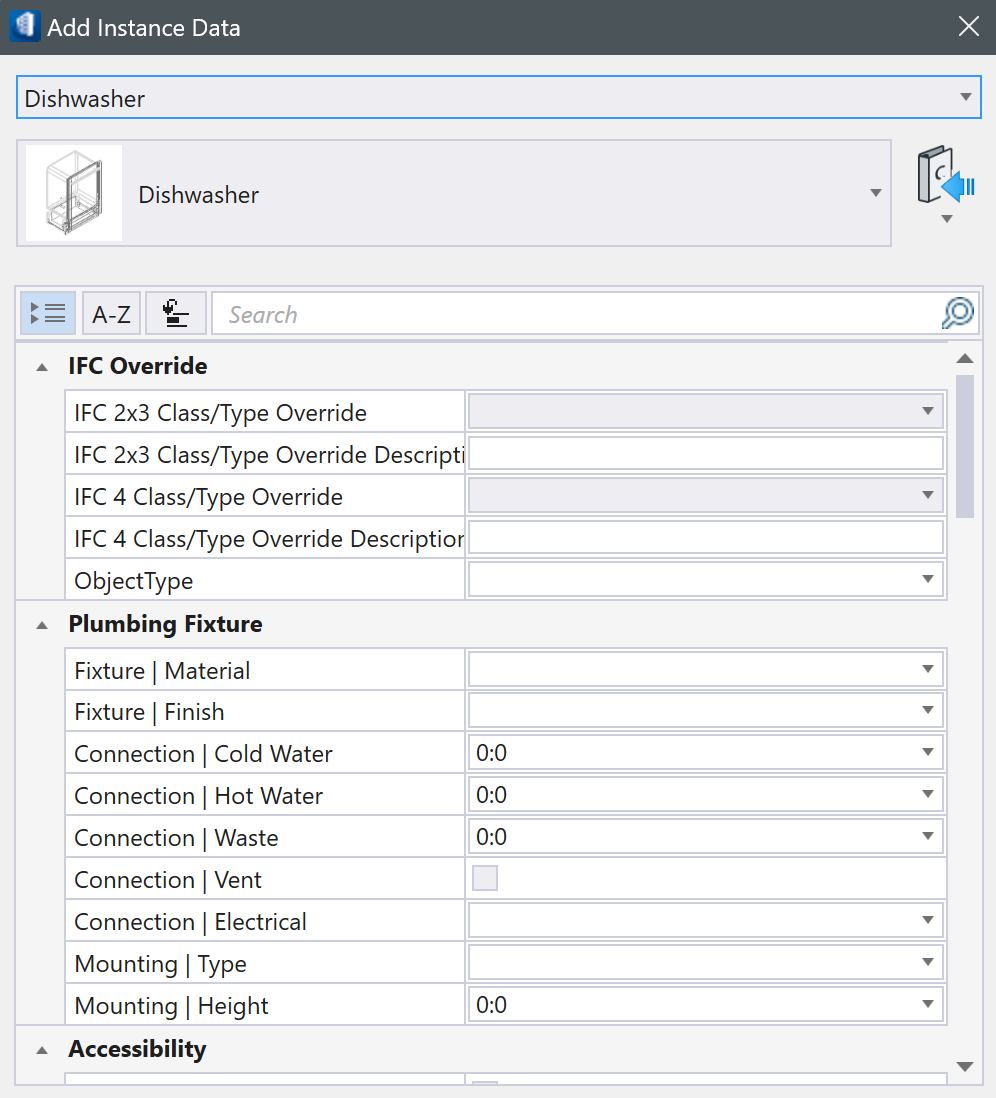

The Add Instance Data dialog allows you to select the desired catalog type and item, along with all of its properties, and apply that data to graphic elements for queries, reports and schedules.
