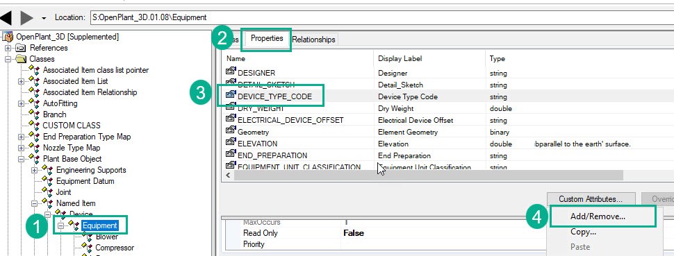

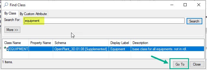

  3. From the search button, search for Equipment Class as shown
  4. Go to Properties tab and select DEVICE_TYPE_CODE property & Add custom attribute as shown below.
  5. Add Parametric Property Marker from Custom Attributes dialog. Make sure to set location as OpenPlant_3D_Supplemental_ModelingViews.01.08 & hit ok.
  6. Select Parametric Status as save from the dropdown as shown below.
  7. Save the schema changes as shown & Relaunch OpenPlant Modeler CONNECT Edition to verify the results.

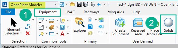

  8. For creating parametric equipment, select Equipment > Solids as shown

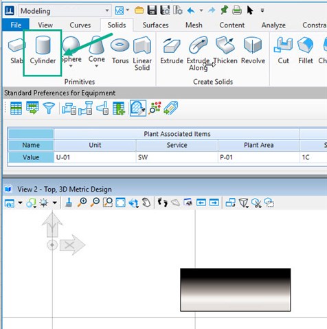

  9. Create a desired solid ( cylinder here) as shown

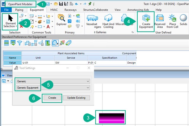

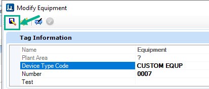

  10. Change the workflow to OpenPlant Modeler > Select the solid > Click on create equipment > Select the desired name & click on create as shown

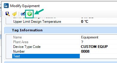

  11. Once Created, insert the desirable fields & click on Apply changes as shown
  12. Now, click on save as shown

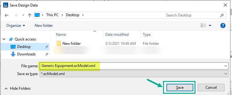

  13. The saving design data dialogue is evoked. Save the file to the desired location as shown
  14. Now open the file & notice that the required property is saved in XML file as shown
