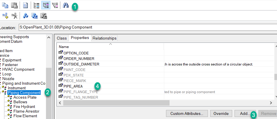

  1. Launch Class Editor V8i,supplement OpenPlant 3D schema with OpenPlant 3D modeling schema. For more information on schema Check Here

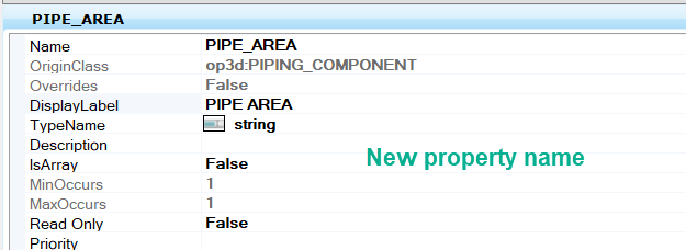

  2. Click on Search icon and look for piping component, click on Piping component and add a new property , here Pipe Area. Illustration below.

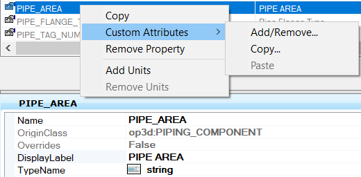

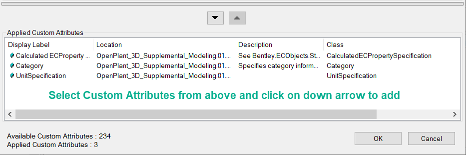

  3. Right click on Pipe Area > Custom Attributes > click Add/Remove button to add the custom attributes

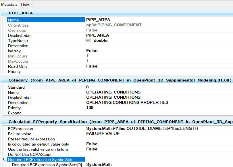

  4. Select the Custom Attributes from above list and using a down arrow bring the selected list down .

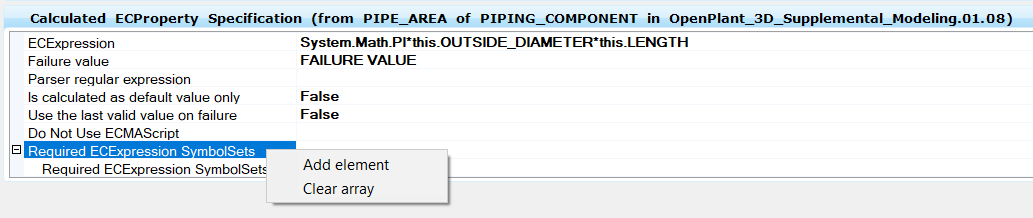

  5. Once all the Custom Attributes added , fill in the details as below image .
    NOTE : While adding Required ECExpression SymbolSets, right click on it and Add element to add System.Math

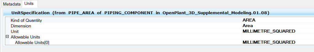

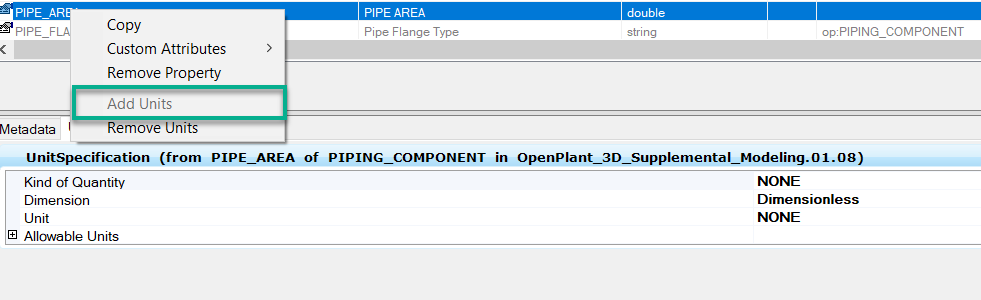

  6. Now right click on Pipe Area property and Add units as fill details as below. Once done Save the schema changes.
    See Image for Area Units which are added.

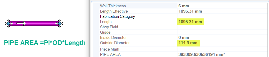

  7. Launch OPENPLANT Modeler and place a small piece of pipe and verify formula.
