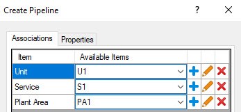

In OpenPlant Modeler CONNECT Edition, to define a new pipeline we need to enter details (Associations & Properties) under Create Pipeline dialog, refer image below.

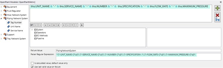

  1. Defined line number format must match as per defined EC Expression.
    The defined ECExpression must match with parser expression.
  2. Correct parser expression must be available to exactly parse the line number (tag name)

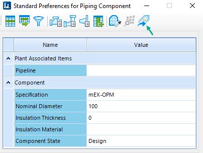

  3. From Standard Preference Dialog, click on Import Tag Instances. Refer image below.

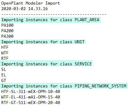

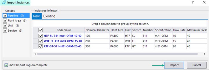

  5. From Import Instances, we can see imported definition as shown below.
  6. Once done, click on Import
  7. From import log file, we can see the details as shown below.

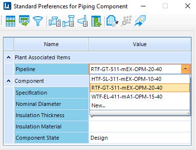

  8. Notice that in Standard Preference Dialog, import pipelines can be seen as shown below.

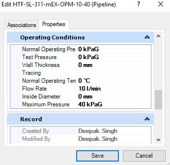

  9. From Pipeline Manager, we can see details of individual pipeline as well. Refer image below.
