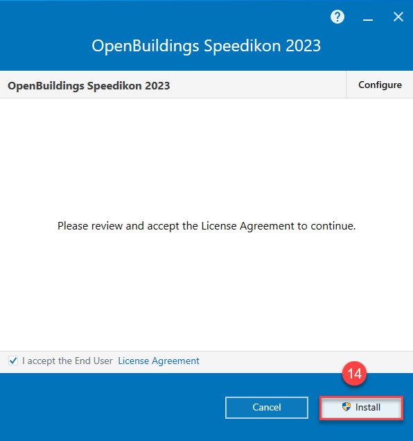

  1. Download the installation file from the Software Downloads Portal. Run the installation file and the OpenBuildings Speedikon installer will open. An internet connection is required for direct installation. This procedure is recommended for the installation of a small number of workstations.
  2. Alternatively, you can create a deployment image. This procedure is recommended for installing many workstations or if the workstation has limited internet access and also enables installation in the background without a user interface. Explanations are available in the help and communities

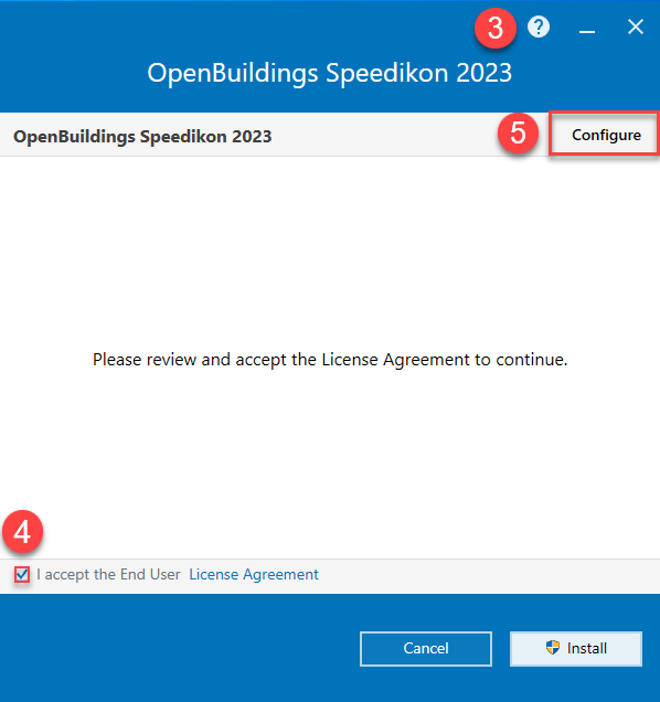

  3. Clicking on the? question mark in the upper right corner of the installation dialog opens the current readme file.
  4. By clicking on License Agreement, you can read the End User License Agreement. Please accept the End User License Agreement by ticking the box.

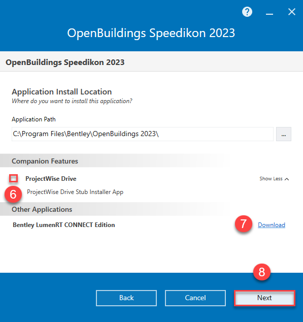

  5. Click the Configure button. The installation directory for the program is displayed. We recommend not to change the path.
  6. You can also install ProjectWise Drive as a Companion Feature. With ProjectWise Drive, you can edit Speedikon projects on a local or network drive and back up the project data to the cloud at the same time. An additional license is required. You can find more information about this in the Update manual of this version.
  7. As a companion application, you can also download and install Bentley LumenRT Designer free of cost via a link. LumenRT Designer allows you to create engaging visualizations quickly and easily.

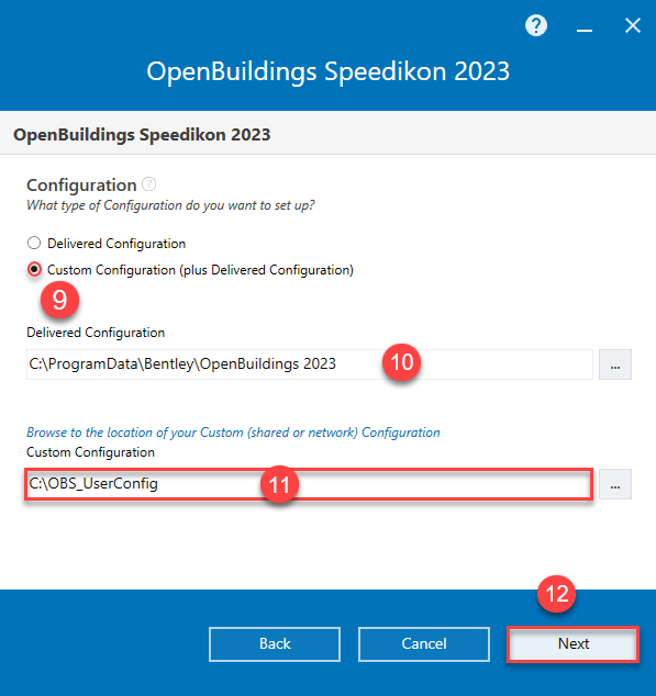

  8. Click on Next. You can now set the configuration.
  9. We recommend choosing the Custom Configuration (plus Delivered Configuration). Please also refer to the chapter Side-by-Side installation in the Readme if you have already installed OpenBuildings Speedikon CONNECT Edition.
  10. The Delivered Configuration path defaults to C:\ProgramData\Bentley\OpenBuildings 2023. This is where Bentley installs files that belong to the dataset and workspace. You can choose the installation directory of the delivered configuration; it can be local or on a server. Usually, a local directory is chosen.

  11. You can define the path for the Custom Configuration. Select the same directory as for the existing CONNECT Edition installation. The custom configuration can be done via a remote path to the share, e.g. \\Server\Freigabe\OBS_UserConfig or via a local path to the share, g. S:\OBS_UserConfig. You should set the path as desired right during the installation. In the Custom Configuration directory, you will later copy or save your customized workspaces and your Speedikon company standards.

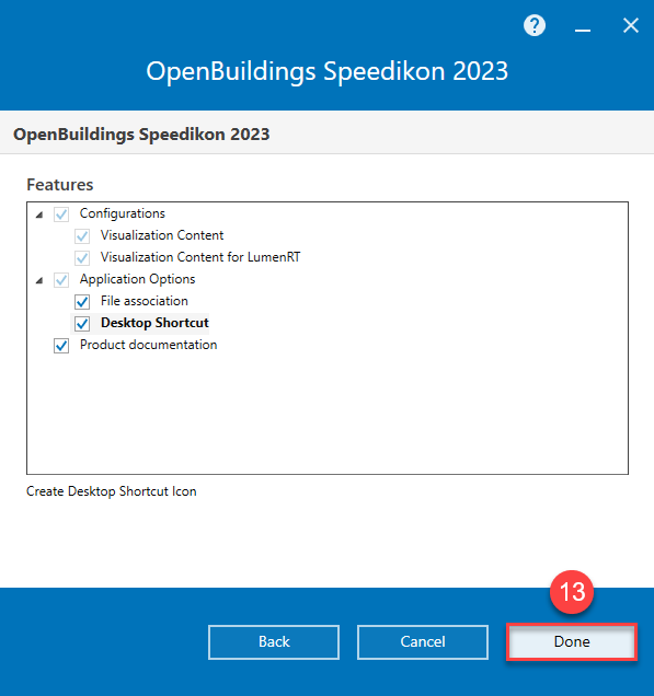

  12. Click on Next. On the installation page "Features", select the options. It is best to leave all the options ticked. If you have limited storage space, you can deactivate the Visualization Content.
  13. Click on Done. The first installation page opens again.
  14. Install OpenBuildings Speedikon by clicking Install.

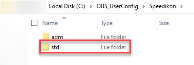

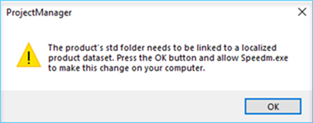

  16. At the first start a message appears once, which you need to confirm with OK. "The product's std folder needs to be linked to a localized product dataset. Press the OK button and allow Speedm.exe to make this change on your computer." Administrator rights are required for this. You can bypass this message via script if the users do not have administrator rights.
    This operation links the dataset to the std folder of the Speedikon installation directory and creates the Speedikon folder in the Custom configuration directory or, if this is not defined in the delivered configuration directory.

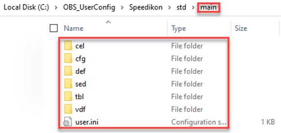

  17. If you want to use your own Speedikon company standard, open the Speedikon folder in the custom configuration directory, or if it is not defined in the delivered configuration directory. If there isn't a std folder there yet, create a new one. If a folder std for the CONNECT Edition has already been set up there, continue with step 24.
  18. In the std folder, create the main folder or, in the case of multiple company standards, a folder with the desired name. Copy your Speedikon company standard into this folder.
  19. Check whether your company standard contains the file standard.d01 in the def folder. If so, delete this file. Create a new file standard.d01 later. Info about this can be found here.

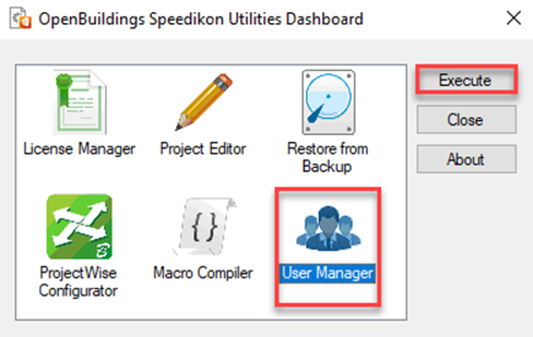

  22. If you want to use the User Manager, start it from the OpenBuildings Speedikon Utilities Dashboard. This can be found in the Windows Start Menu under OpenBuildings Speedikon.
  23. Create the desired users and assign the appropriate rights. Import the company standard subfolders with the Import button. Select the desired company standard. The exact procedure is described here.

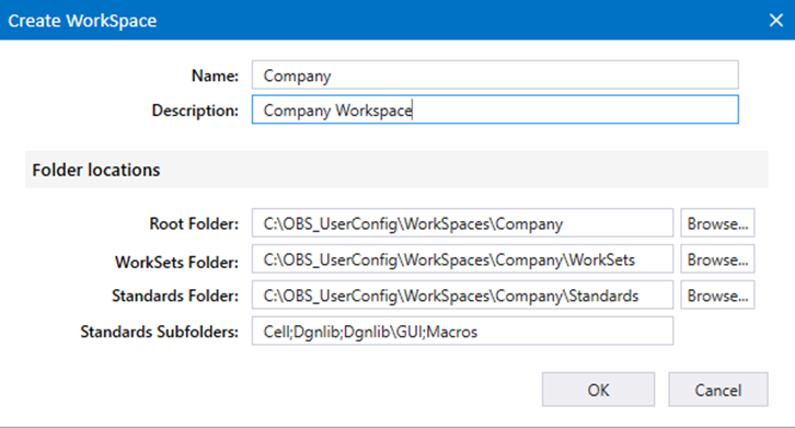

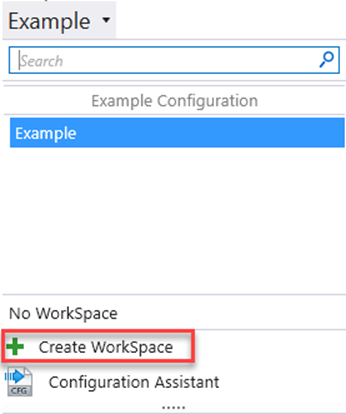

  27. Create a new WorkSpace
  28. You can freely assign the name. Check that this is created in your configuration directory.
  29. Now create a WorkSet in this workspace. You can also freely assign the WorkSet name.
  30. If you have previously used customized MicroStation files in your workspace, copy these to your newly created workspace. Please be sure to create new printer driver configuration files in the pltcfg folder of V8i in 2023.

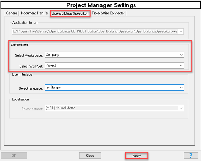

  31. Start Speedikon. Press the F6 key and select the OpenBuildings Speedikon tab.
  32. Select the Workspace and the WorkSet and confirm with Apply

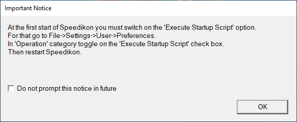

  35. When you start OpenBuildings Speedikon for the first time, the following message appears:
  36. Please follow the instructions and activate the option Execute Startup Script under the preferences. The change in the setting of the Execute Startup Script option is saved in the Personal.upf file in the prefs folder. The prefs folder is usually located at: C:\Users\FirstName.LastName\AppData\Local\Bentley\OpenBuildingsSpeedikon\23.0.0\prefs.
