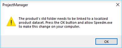

The first time you start OpenBuildings Speedikon after installation, a message appears that requires administrator privileges to proceed.
Can this customization also be done via script, since the users do not have administrator rights?
What must be done for this, or what changes are made here?
Required Steps
        1. Speedm.exe creates a symbolic link at startup if it does not already exist. This symbolic link can be created by a script.
        2. For this, the command mklink from the cmd-shell must be used, e.g.,
         C:\Program Files\Bentley\OpenBuildings <product_version>\OpenBuildingsSpeedikon>mklink /D std Localization\DIN
