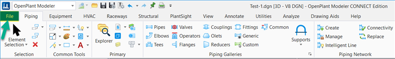

    In dgn go to  File tab,Below OpenPlant Modeler workflow.

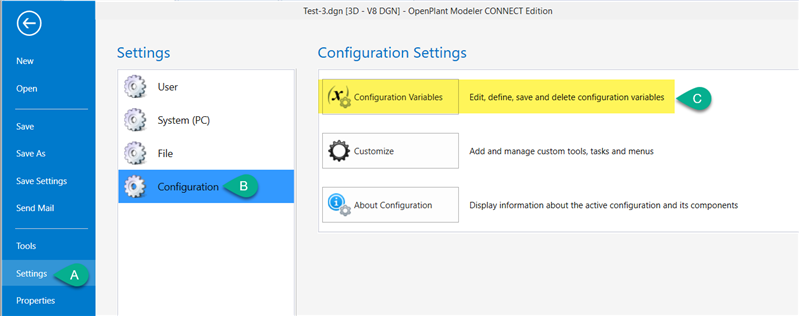

  3. In Files go to Setting option which would pop up more four sub-option in Settings.
    Select Configuration and then Configuration Variable as shown in below image.

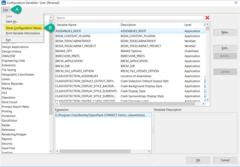

  4. Dialog box with Configuration Variables Is popped up. In it go to File and Show Configuration Values

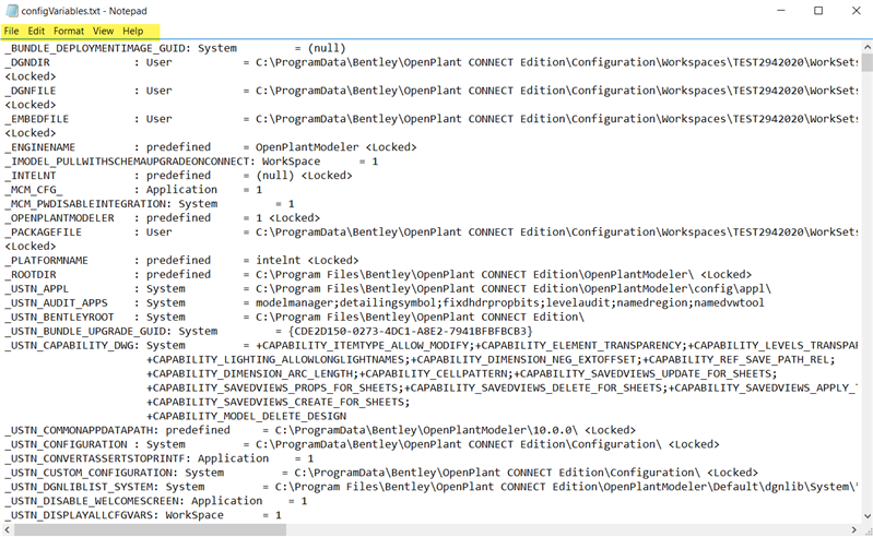

  5. Configvaribales.txt gets generated as shown below and can be saved through file option.
    This configvar report helps in understanding  list of available configuration variables which control various OpenPlant functions and procedures in comparison with default one to customize one. And in knowing of  keyins,Schemas, Locations of files generated etc.For more details descrition kindly view below link.
