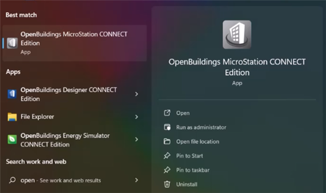

  1. Open the file with the “Openbuildings Microstation CONNECT Edition” shortcut. This is automatically installed on your machine and has a grey icon. You can find it through the search bar.

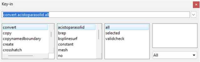

  2. In OpenBuildings Microstation CONNECT Edition use the command "convert acistoparasolid all" in the Key-in dialog. This will convert all ACIS elements into Parasolid elements that are native to OpenBuildings Designer.

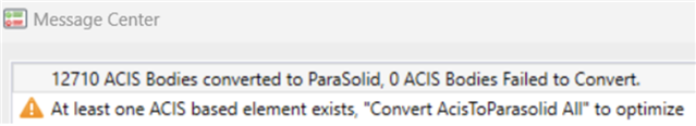

  3. Make sure you have completed the operation by checking the Message Center. Then save the file and close it.
