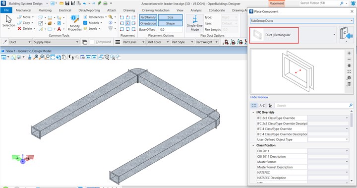

  1. At first, you will have to place some Rectangular Ducts in your model.

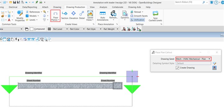

  1. Then you will have to create a plan of it and move to the drawing model.

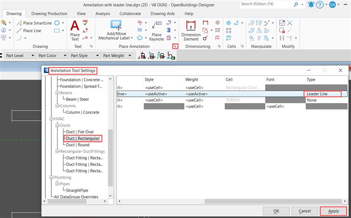

  1. Then under Drawing tab opened the “Annotation Tool Settings” dialog box and from there under Rectangular Duct select the “Type” as Leader Line and hit on Apply.
  1. Then in the Element Annotation tool check on the “Use Mechanical Stacked Annotation” and annotate the ducts. Finally, you can see that annotations are created with Leader Line.
