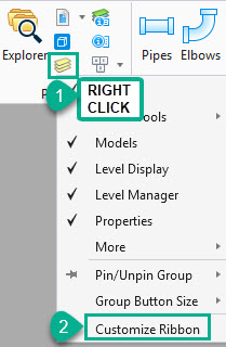

  2. From Tools ribbon, expand your desired workset & select OpenPlant Modeler Click on Class Editor as shown below.

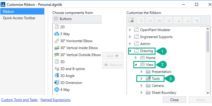

  3. From Customize Ribbon dialog, expand Drawing > View > Tools as shown below.
  4. Right mouse on Tools & select Remove as shown below.

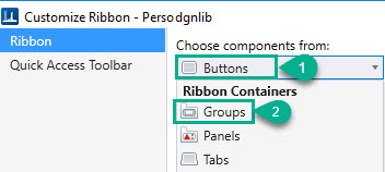

  9. Tools group is selected, change the “Component from Buttons to Groups”. Refer the image below.

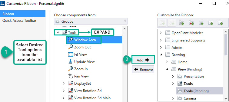

  10. From the list, expand Tools > Add desired tools from the list > Click on Add. Refer the image below.
  11. Once all the desired tools have been added from multiple available groups options, click on Apply as shown below.

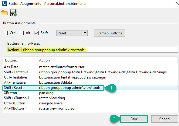

  13. From OpenPlant Modeler window, search for Button Assignment as shown below
  14. Select the Button Assignments option.
  15. From Button Assignments dialog, select Shift + Reset & change the Action as shown below.
     Action: ribbon grouppopup admin\view\tools.
    Once Action has been updated, click on Save to save all the settings.
