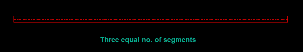

Standard: Used to divide a length of pipe into equal segments using the length defined in the field.

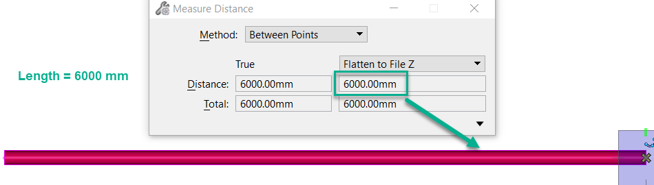

  1. Create a pipeline of Desired length, here L = 6000 mm.
  2. Click on Break option and select Standard.
  3. Upon Selecting Standard, key in the data value i.e. 2 and the pipe will be divided in 3 equal segments.

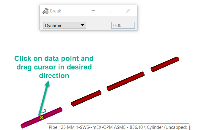

Dynamic: Pick a point where the break is to start, then move the cursor in either direction to define the length of the gap.
  1. Place a pipeline of Length = 6000 mm, now choose dynamic option and in message center read the message to select the end of the component/pipe.
  2. Click on mid of pipeline and drag the cursor to define the direction in which gaps are needed.

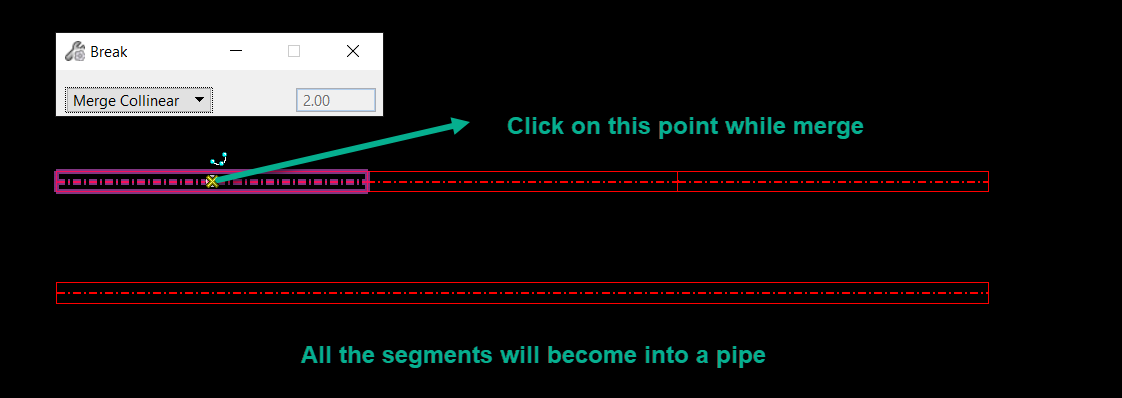

Merge Collinear: Allows you to merge several pieces of pipe into a single length of pipe.

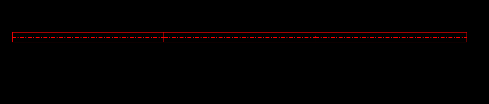

  1. Below is an image of a pipe divided into different segments.
  2. Now select the option Merge Collinear, select a data point on one of the segments and it will merge while pipe in single component.
