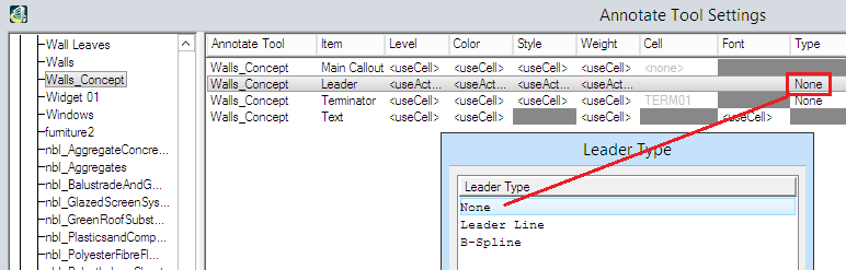

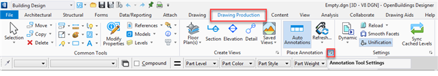

In the DataGroup Annotation tool settings you can turn on leaders and select a terminator where appropriate.
CONNECT Edition: From the Drawing Production tab > Place Annotation > Annotation Tool Settings:
V8i: Building Designer menu > Annotate Tool Settings, click on the Type shown and alter as required, here it is set to none and can be changed to Leader Line or B-Spline.

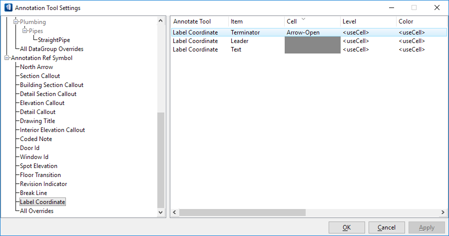

The same settings apply to the symbology and terminators for Annotation tools such as Label Coordinate. The terminators for the Label Coordinate tool are stored in their own file specified by TFANNOTATION_LABELCOORDTERM_LIBFILE:
C:\ProgramData\Bentley\OpenBuildings CONNECT Edition\Configuration\Datasets\Dataset_NM\Cell\LabelCoordinateTerminator.cel

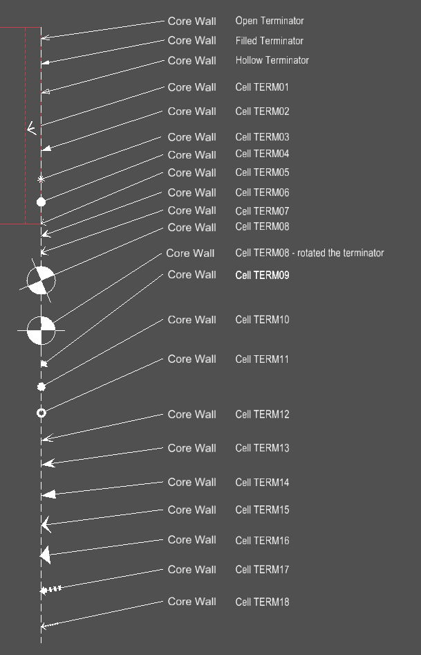

Available terminators in the NM Dataset
These are stored in the file specified by the configuration variable BB_TERMINATOR_CELLLIB, in the case of Dataset NM this is:
C:\ProgramData\Bentley\OpenBuildings CONNECT Edition\Configuration\Datasets\Dataset_NM\Cell\Terminator.cel
*TERM08 can be rotated back to vertical if appropriate.
