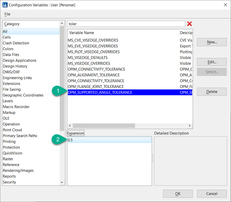

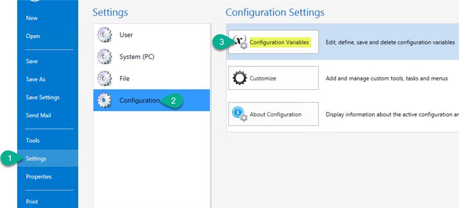

2. Go to FILES > SETTINGS > CONFIGURATION > CONFIGURATION VARIABLES.
3. Edit the config variable as shown below from 2.5 to 0.5

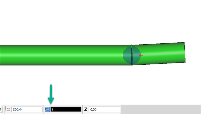

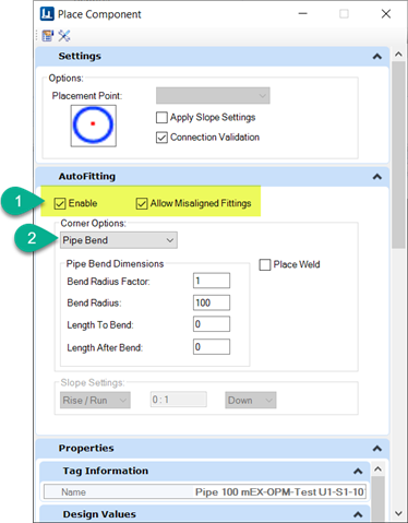

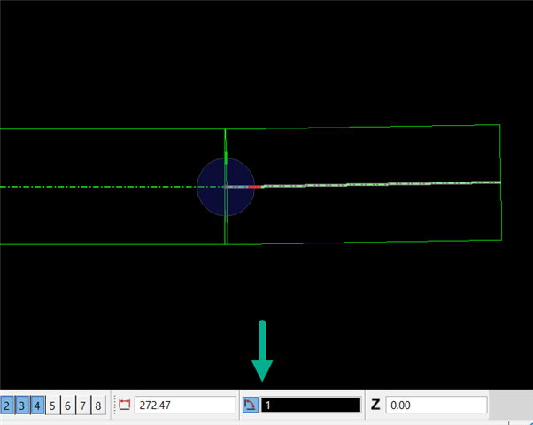

4. Reopen OPM CE and route a Pipeline, in the placement window prior to routing, do below settings.
5. Reopen OPM CE and route a Pipeline, in the placement window prior to routing, do below settings.

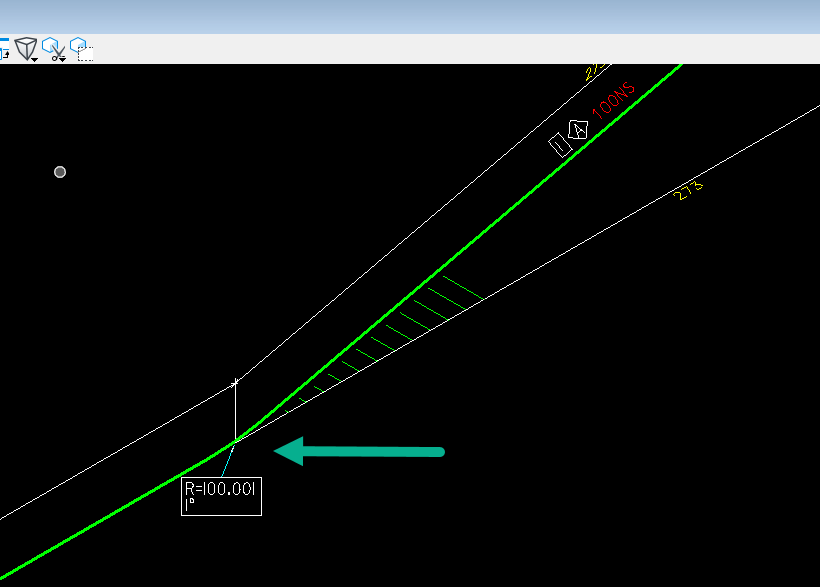

6. Generate Iso Output and witness no weld info.
