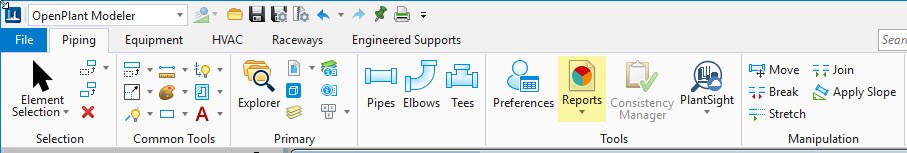

  1. Select OpenPlant Modeler workflow.
  2. From the Piping Ribbon, Tools group, select Reports.

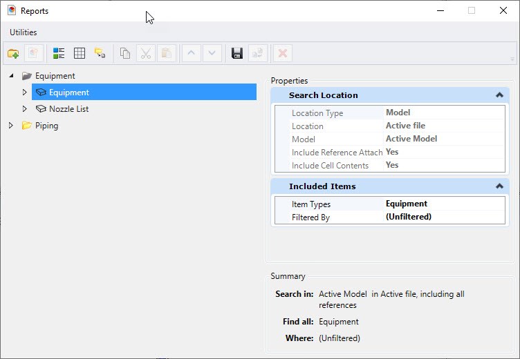

  3. Select In Drawing Reports.
  4. A dialog will open. Select the category of reports that need to be previewed. For e.g. Equipment.

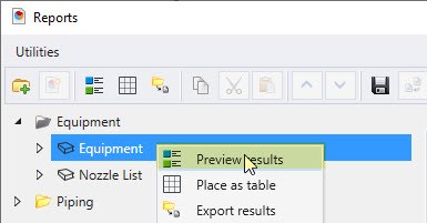

  5. Right-click and select Preview.

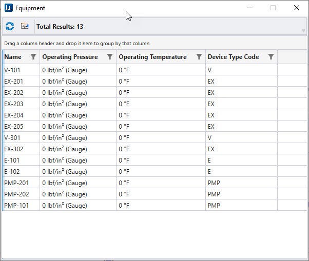

  6. A window with preview results will open.
