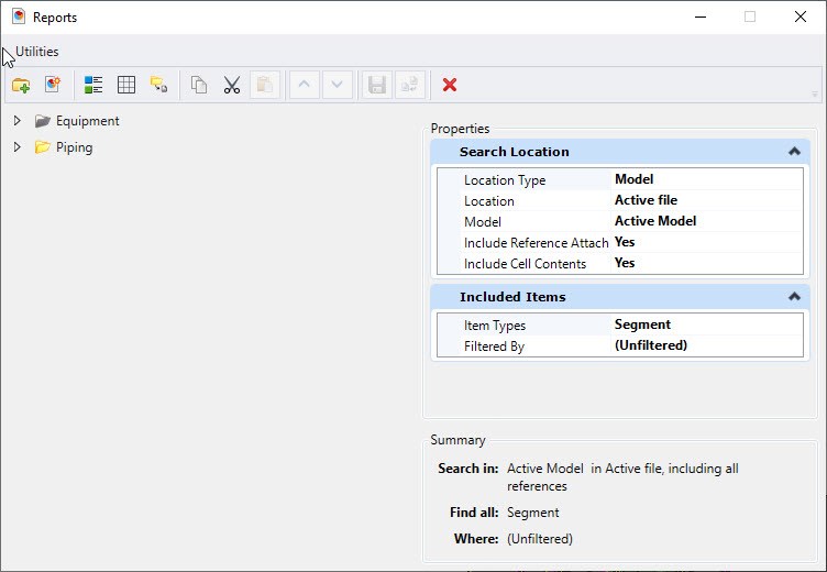

  3. From the Piping ribbon, Tools group select Reports.
  4. Select In Drawing reports.
  5. The In Drawing reports dialog will open.

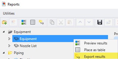

  6. Expand the Equipment node and select the first report.
  7. Right-click on the Equipment and select Export Results.
  8. A dialog will open asking us the directory where the output could be saved.

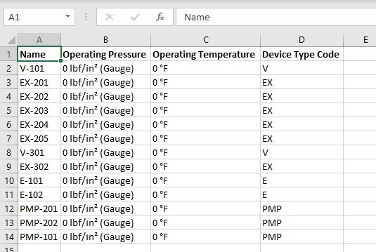

  9. Save this report, it will create an excel readable report in the provided directory.
  10. Review the reports.
