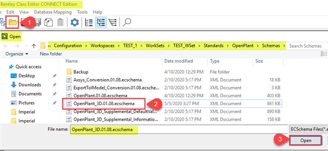

  1. Launch Bentley Class Editor.
  2. Navigate to below highlighted folder location of your desired workset. Select OpenPlant_3D.01.08.ecschema & click on Open to load this schema.

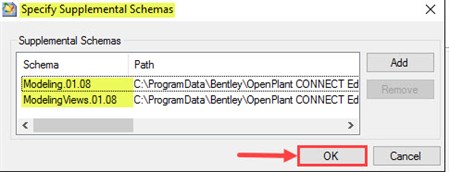

  3. Supplement the schemas OpenPlant_3D_Supplemental_Modelling & OpenPlant_3D_Supplemental_Modelling views as shown

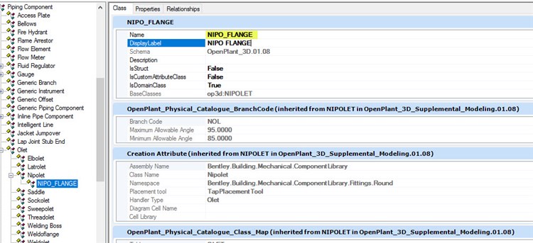

  4. Navigate to Nipolet class to Add subclass as shown
    Nipolet > Right Click > Add Derived Class
  5. Define new class name as NIPO_FLANGE. Refer below image for details.

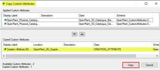

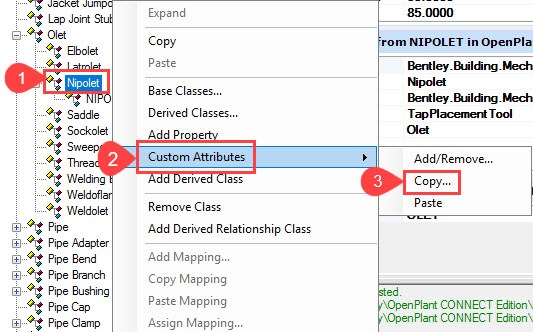

  6. Copy Custom Attribute of Nipolet class as shown below
    Nipolet > Custom Attributes > Copy
  7. Select Creation Attribute to copy as shown

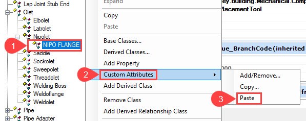

  8. Paste the Custom Attribute on Newly created Subclass NIPO_FLANGE as shown
    NIPO_FLANGE > Custom Attributes > Paste

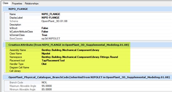

  9. Creation Attribute is successfully copied as shown
  10. Save all changes.

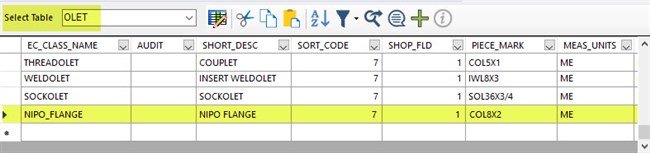

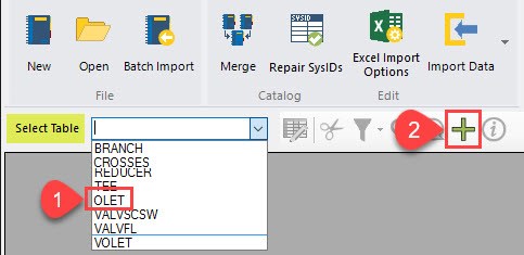

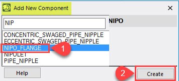

  13. Select OLET & Add Record as shown
  14. Add New Component NIPO_FLANGE as shown
  15. As shown new Row is added for NIPO_FLANGE
  16. Add required information in a newly created Row. For an example Add following fields
    PIECE_MARK > COL8x2
    CATALOGUE > BONNEY FORGED
    PIPE_OD_M > 625
    FLNG_OD_B > 6
    FLNG_TH_B >  1
    PIPE_OD_B > 2.375
    COMP_LEN > 6.5
    BRAN_SIZE > 2
    END_COND_1 > FL
    END_COND_2 > PL
    MAIN_SIZE > 8

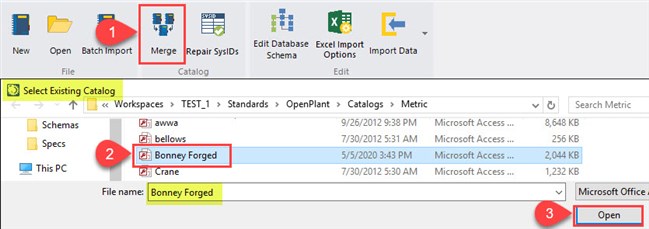

  17. Merge the Edited Catalogue to previous catalogue as shown

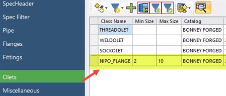

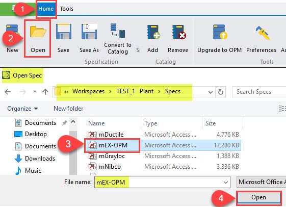

  18. Open the desired Spec as shown
  19. As shown, record is added successfully for Nipo Flange

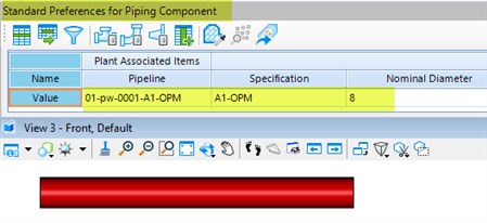

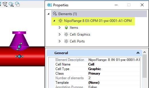

  21. Place a Pipe of desired size ( Here 8 inch ) as shown
  22. From Piping, Select Key-in & enter below mentioned key-in to place Nipo flange on the routed pipe.
    mechaddin place NIPO_FLANGE dsc=Piping
  23. The NipoFlange is placed as shown
