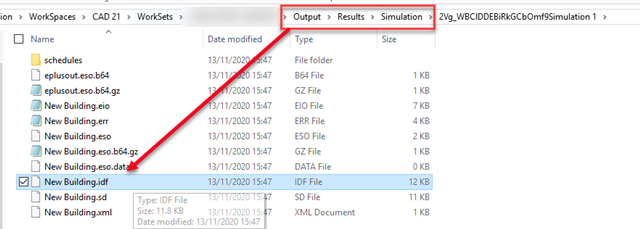

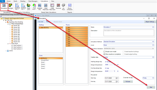

An IDF file can be obtained be obtained upon running a Dynamic Simulation in OpenBuildings Energy Simulator.
This file will be generated automatically and can be obtained from the projects Workset folder, within the Output > Results > Simulation folder:
