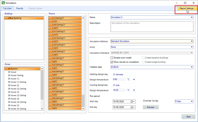

Once in the Simulation menu, click on Report Settings:
You will find that this opens the Defaults Manager menu, as below. This is where to define your Simulation report preferences:
