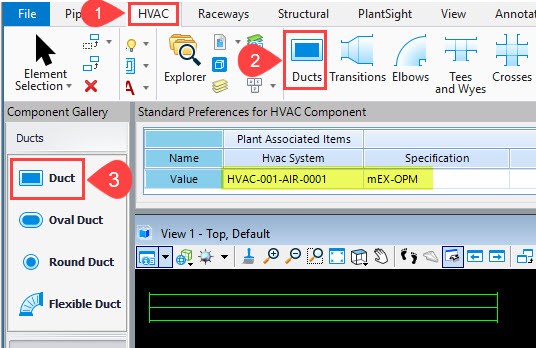

In OpenPlant Modeler CONNECT Edition, the requirement is to show center-line for HVAC ducts.
In OpenPlant Modeler CONNECT Edition, While placing HVAC rectangular or oval duct center-line is not shown, refer image as shown below. Center-line representation for ducts does not show by default, this wiki article explains how to represent the center-line for ducts.

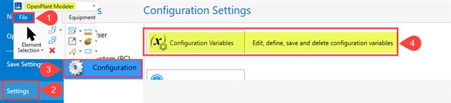

  1. Launch OpenPlant Modeler CONNECT Edition.
  2. Choose the required Workspace, Workset & open any design (.dgn) file.
  3. From File > Settings > Configurations, select Configuration Variables, refer image as shown below.

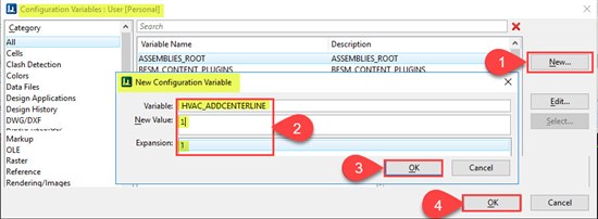

  4. Add new configuration variable as HVAC_ADDCENTERLINE. Refer sequential steps as bulleted below.
  5. Save Configuration & Relaunch OpenPlant Modeler.
  6. From HVAC > HVAC Galleries > DUCTS place a Rectangular Duct as shown below to verify results.
    Notice that center-line for routed duct can be seen.
