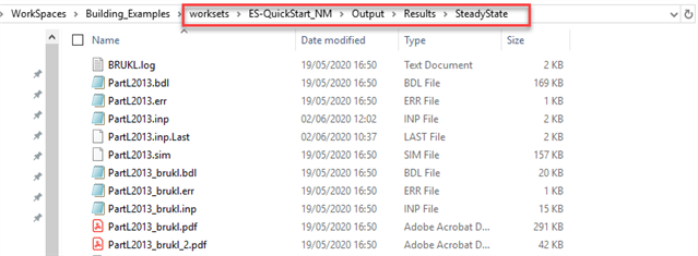

All PartL input files, along with related XML, are stored within the Workset folder for the project, in the location:
...\Output\Results\SteadyState
For example, see the Output folder for the ES-Quickstart_NM training workset below:

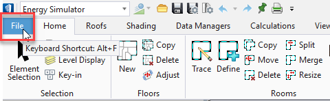

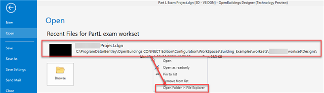

If you are unsure where your Workset folder is, please click on File:
Then, the location of the project will be shown as below. Right-clicking on this will allow you to 'Open Folder in Project Explorer':
