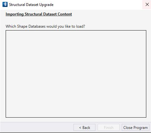

Problem Description
After upgrading your OBD when starting it the Import Structural Dataset Content dialog box is prompted. When trying to select shape database OBD closes forcefully. How to resolve this error?

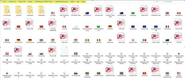

  1. At first, you will have to go to this location: “C:\Program Files\Bentley\OpenBuildings CONNECT Edition\OpenBuildingsDesigner\Default\appl\Shapes” and check if all the content of the Shapes file is available.
