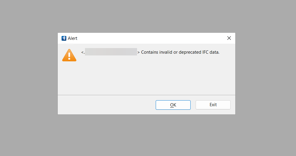

While opening an IFC file from OpenBuildings Designer it is showing an error message
The alert message while opening an IFC file is coming in OpenBuildings Designer Update 10 as due to security reason some of the old IFC schemas has been deprecated.
But the IFC files can be open with the configuration variable IFC_ALLOW_DEPRECATED_SCHEMA=1.
