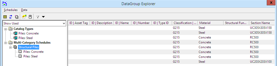

Including several Catalog Types in one schedule report is available from AECOsim SS5 onwards, see help topic 'Revised Interface for Creating and Modifying Reports' for more details. For instance, in previous versions Concrete and Steel Piles would have been in separate schedules. In SS5 a schedule can be created that contains both.
Here is an example:
Open DataGroup Explorer and click the Create New Schedule icon:
Give your new schedule a name and either select an existing Destination file or create a new one:
Click Edit Schedule Options.
In this example we don't need to see the Architectural Catalog Types so click the arrow to the left of Architectural to collapse that group.
The two Pile types are highlighted in bold as both have instances in the active file.
Select both then click the upper single arrow:
to move them to the right:

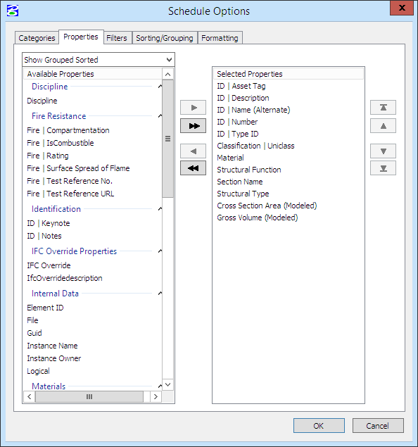

Click the Properties tab, then select the properties that you wish to include in your schedule using the left/right arrows:
The order of the properties in the schedule can be changed using the up/down arrow on the right.
Further options to refine the contents and appearance of the schedule are offered by the following three tabs. The Formatting tab for instance allows column headings to be changed from the default of the property name listed to a name that fits in with project or owner standards.
For instance, I don't want to the see the '(Alternate)' after the ID | Name property so I can double click it to edit:
Click OK when complete.
