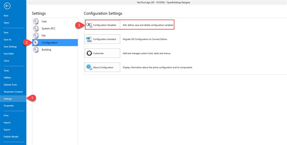

  1. From the backstage go to Settings >> Configuration >> Configuration Variables

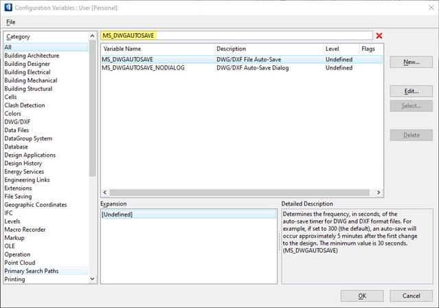

  2. Search for variable: MS_DWGAUTOSAVE
           If MS_DWGAUTOSAVE is Undefined, by default every 300 seconds the autosave function will run.

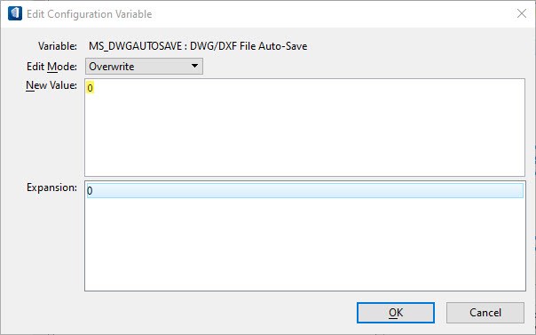

  1. Click on Edit, and add a New Value of "0" (Zero)
