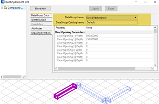

I am  unable to edit/modify any element by Modify Properties dialog or from the Schedules dialog How can I resolve this issue?
Resolution:
  1. When you are unable to modify any elements the first thing, to check is the DataGroup instance name assigned to that element is present in the active Open Buildings Designer configuration. If not, then you will need to reassign the DataGroup instance data to one  which is available in the OpenBuildings Designer configuration or determine why the applied instance data is missing from the configuration. .

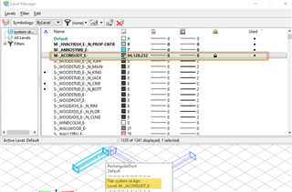

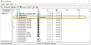

  2. There can be another instance where the level of that element is locked and at those times, the element modification is not possible.
    In the above image you can see that the Level associated with the element is locked, so clicking on the lock icon will make the level unlocked. Once it is unlocked, you should be able to perform modification.
So, to resolve this issue, please properly check all of the above three steps.
