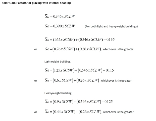

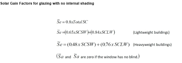

In some instances, it is possible to source glazing data from manufacturers for your project. If Solar Gain Factors are not included with this information then you can calculate them using the method below.
Method

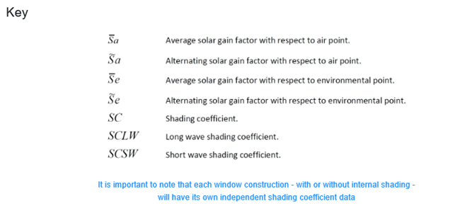

The equations below refer to windows with and without internal shading. Each window construction - whether with or without internal shading - will have its own independent shading coefficient data.
Notes
