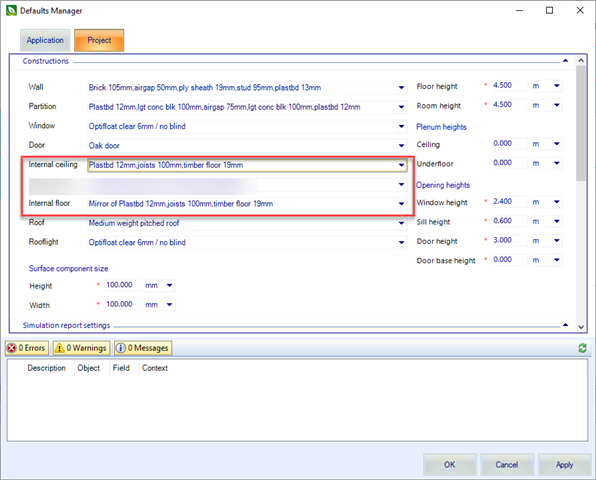

To ensure the consistency of your surfaces, the layers in your internal ceiling should be a mirror image of those in your internal floor construction.
Method
This is done automatically by the software when you choose your Default construction types.
For example, when the below internal ceiling is selected, the Internal floor type updates automatically to show the mirrored construction.
