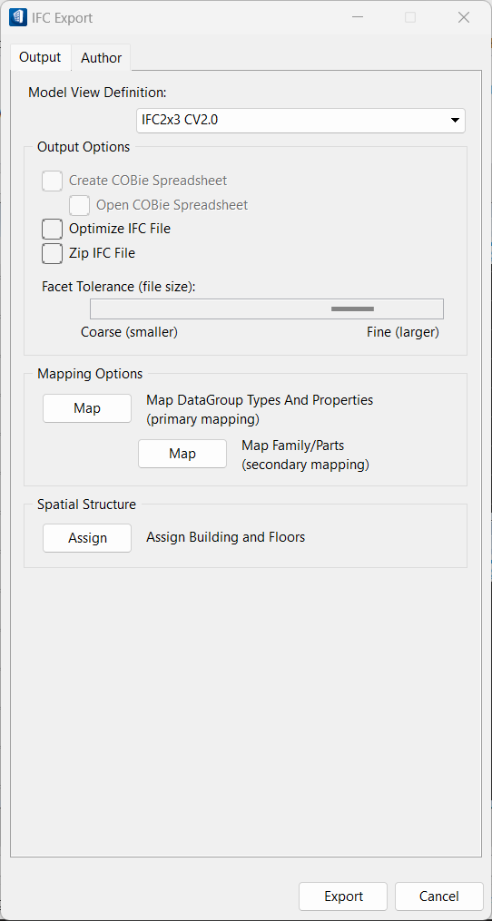

Case 1. Exporting to IFC without extended dataset:
A) Start OpenBuildings Designer and open the file required to be exported to IFC.
B) Go to File > Export > Exchange File Types > IFC (*.IFC)
C) Thus, the following window appears.
The active DGN file and all displayed References are exported using information and settings specified (Output tab). Author information can also be entered (Author tab) to be exported with the model.
D) The exported IFC (along with the IFC Log) is stored in the following path by default.
C:\ProgramData\Bentley\OpenBuildings CONNECT Edition\Configuration\WorkSpaces\Work_Space_Name\worksets\Work_Set_Name\Output\IFC

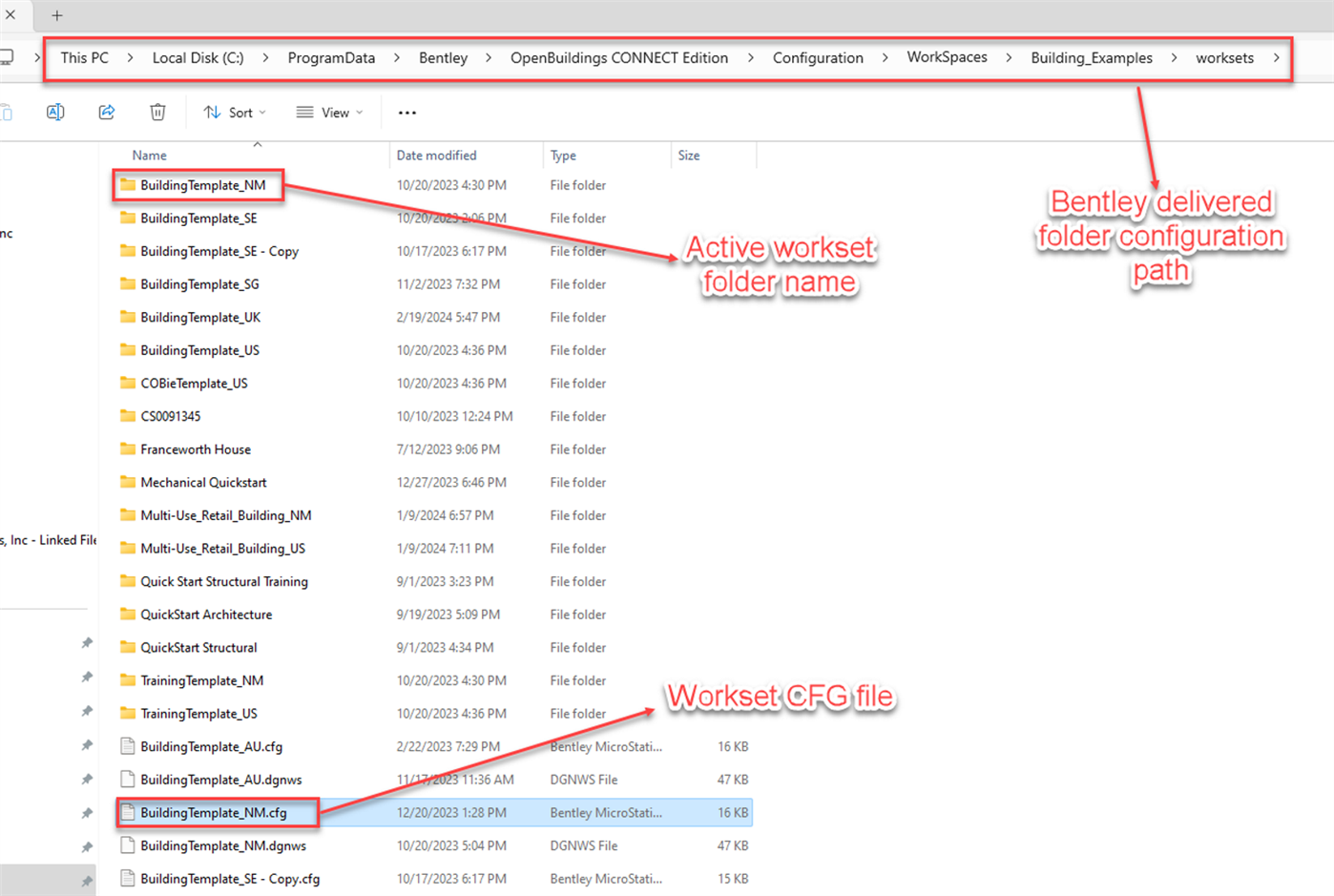

A) Close all instances of the OpenBuildings Designer that is active on the system.
B) Go to the worksets folder located at the following default path.
C) Then open the workset CFG file using any text editor (e.g., Notepad or Notepad++ etc.).
For example, if the target file (to be exported to IFC) is to be opened using the workset named "Building_Template_NM", then the file named "Building_Template_NM.cfg" has to be opened located inside the worksets folder.

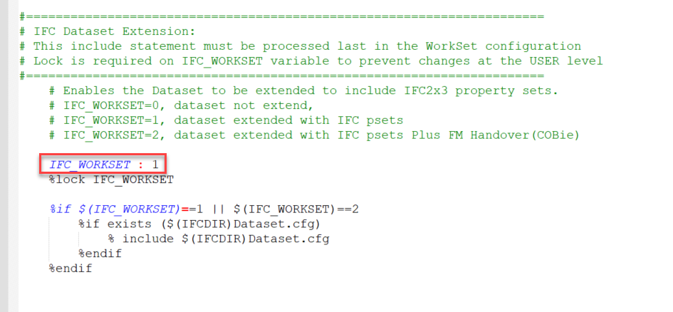

D) Then scroll down to the bottom most part of the text file and assign the value of the variable 'IFC_WORKSET' to 1. Then save and close the CFG file. This extends the dataset with IFC property sets.
E) Then restart the OpenBuildings Designer.

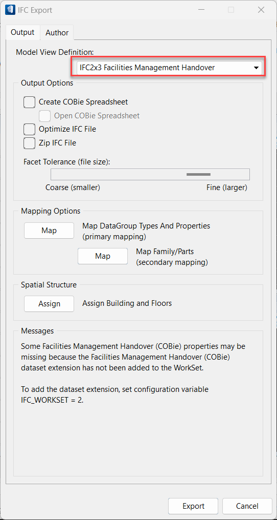

Case 3. Exporting to IFC with extended dataset with IFC Psets plus Facilities Management Handover (COBie)
A) Follow the steps up to point (E) described in case 2. The only difference is you have to assign the value of 'IFC_WORKSET' to 2 in this case.
B) Then go to File > Export > Exchange File Types > IFC (*.IFC). Then select Facilities Management Handover in the IFC Export dialog box and click Export.
