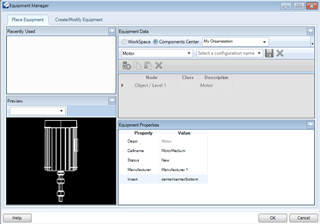

Components Center (Technical Preview)
Components Center is a cloud-based digital component library and catalog management service. It allows users to efficiently manage their digital component libraries while providing their designers with approved, proprietary components as well as manufacturer's content via subscriptions.
Cell-based equipment can now be stored as components in Components Center.  The Equipment Manager allows you to place cells from Components Center in addition to local or shared cell libraries in a WorkSpace.
Components Center integration is enabled in the Options > Components Center dialog by selecting the Enable Components Center checkbox.

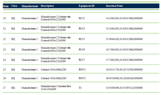

New Report Template
A new report template named, "Detail_Equipment" has been provided that lists the ID of each equipment and it's position (coordinates) in the 3D Model.

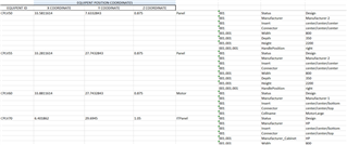

Excel Equipment Import Now Includes UDAs
The Excel equipment import is now able to import user defined attribute (UDA) values listed in the Excel file provided that the dataset you are using has those user defined attributes defined.
