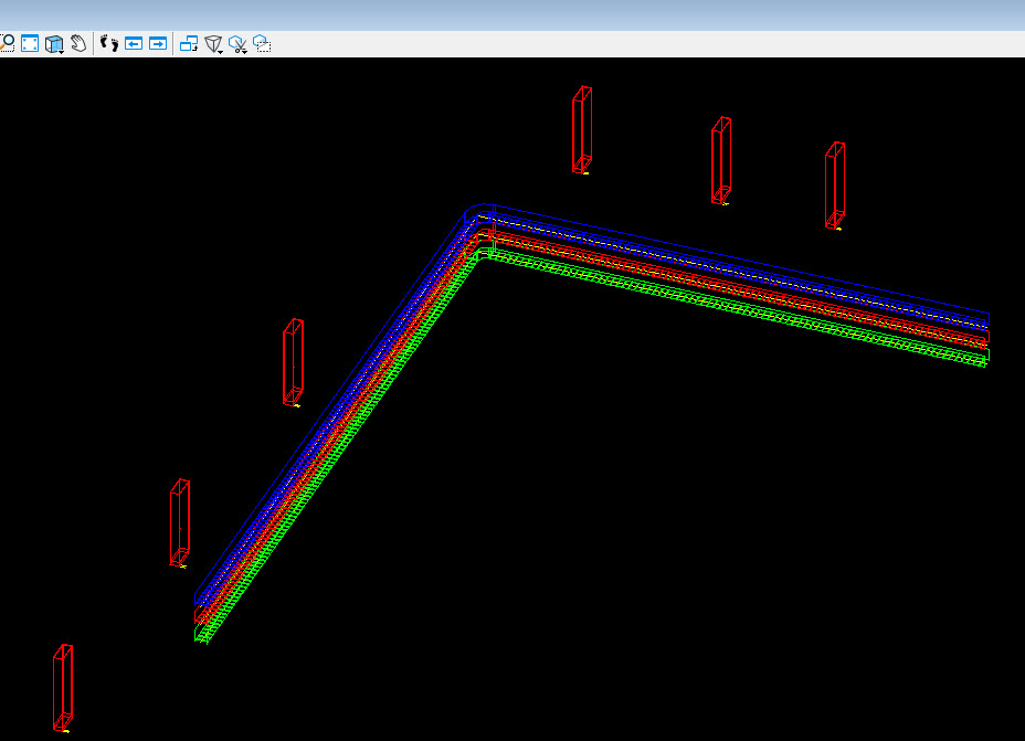

  1. Open the raceway DGN file or the file which is registered as 3D Model Raceway. Route some raceways with different voltage levels.
    By referencing the raceway DGN file to the Equipment DGN file, place some equipment near to the raceway systems and back to raceway DGN file again for using AutoPlance Conduit tool.
    Alternatively, you can register the test DGN file as 3D Model Equipment * Raceway and place raceway and equipment in the same file.

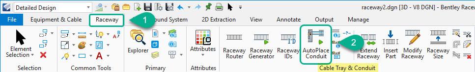

  1. Navigate to the Raceway ribbon tab and in Cable tray & Conduits panel click on the ‘AutoPlace Conduit’ tool.

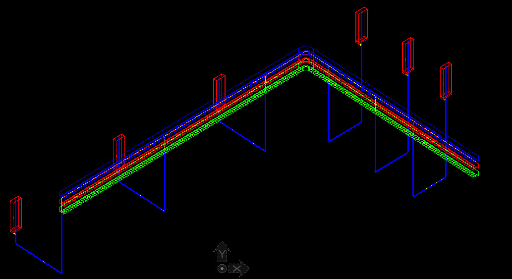

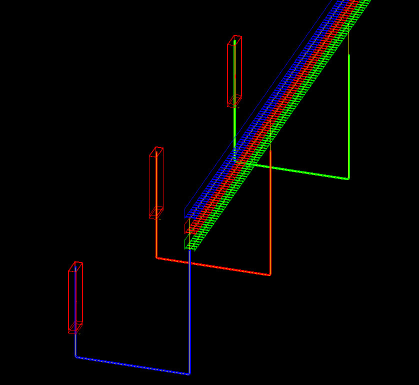

  5. Conduits will be generated automatically with the specified distance and voltage levels.
  6. Notice how the software connected to the raceways that matched the selected voltage of the conduit. If your equipment requires additional conduit connections for other voltage levels you can run the tool again selecting another voltage level in the Raceway Properties dialog. Alternatively, you can assist the AutoConduit tool in generating all the conduit connections at one time by following the instructions in this article:
