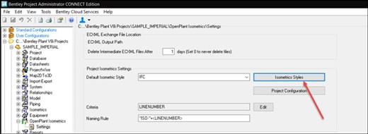

1.Open the Project Administrator

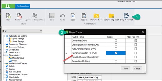

2.Launch the Isometric Configuration setting
3.Select the Isometric style, go to Output Format and select the PCF file option.
4.Generate the Isometric drawing for the drawing file.

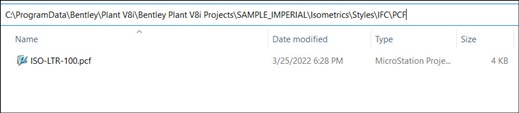

5.PCF file will generate in the below directory
C:\ProgramData\Bentley\Plant V8i\Bentley Plant V8i Projects\SAMPLE_IMPERIAL\Isometrics\Styles\IFC\PCF
