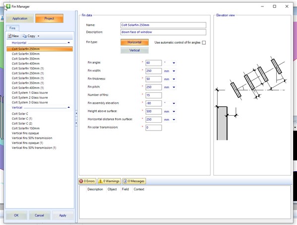

The article shows how Energy Simulator can be utilised to model a Brise Soleil for your energy model.
Method

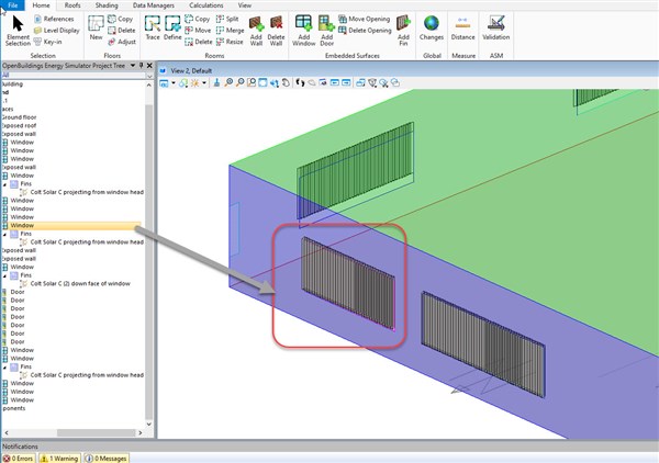

Brise Soleils are architecturally designed devices that work as a static external shading equipment for the building. OpenBuildings Energy Simulator offers the options of adding fins to the openings that replicate the functions of a Brise Soleil in an energy model. To do so:
You can assign the same in front of other openings as well. Just make sure that you are choosing the right surface before assign the fin to it.

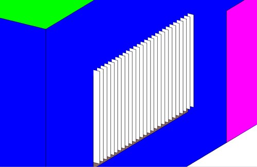

The model should look like this:
