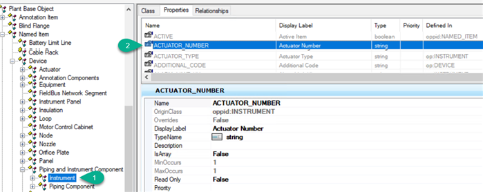

  1. Launch a Class Editor and load OpenPlant_PID schema.
  2. Supplement it with OpenPlant_PID_Supplemental_Design.01.08 schema.
  3. Go to Instrument class and create new property ACTUATOR_NUMBER.

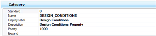

  4. Add Custom Attribute, Category as shown below.

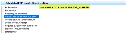

  5. Create another property ACTUATOR_TAG on Instrument class.
  6. Add a Calculated EC Property Specification attribute on ACTUATOR_TAG property and set EC Expression as this.NAME & "-" & this.ACTUATOR_NUMBER shown below.

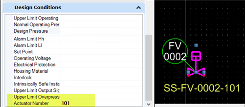

  7. Add Annotation Custom Attribute and set the count to 1 as shown below.
  8. Save the changes in the schema and verify the result in OPPID.
