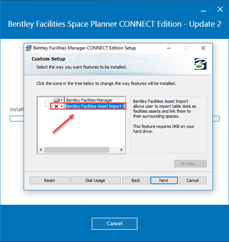

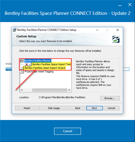

  5. Install Bentley Facilities Space Planner and Administrator
    During Installation choose Custom Setup and enable the Asset Import Wizard option.
