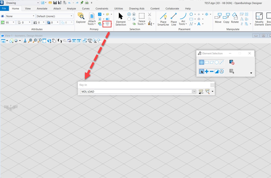

Below is the workflow that will allow you to use the Label Coordinate tool in MicroStation mode.

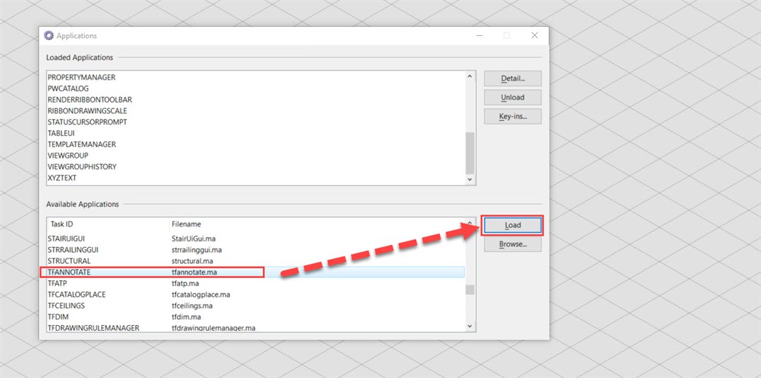

1. In OpenBuildings Designer MicroStation Mode open the Key-in window and run "MDL LOAD" and then load the tfannotate.ma from the Available Applications dialog.
2. Now run the Key-in tfplace Label coordinate to open the Label Coordinate dialog.
