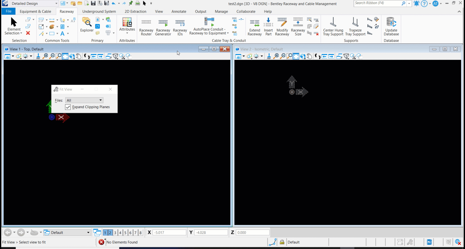

iTwin Workflows
  • Ability to attach models directly from iModel in connected projects
  • Import iModel tool allows you to import equipment from an OpenPlant Modeler file that is attached directly from an iModel.

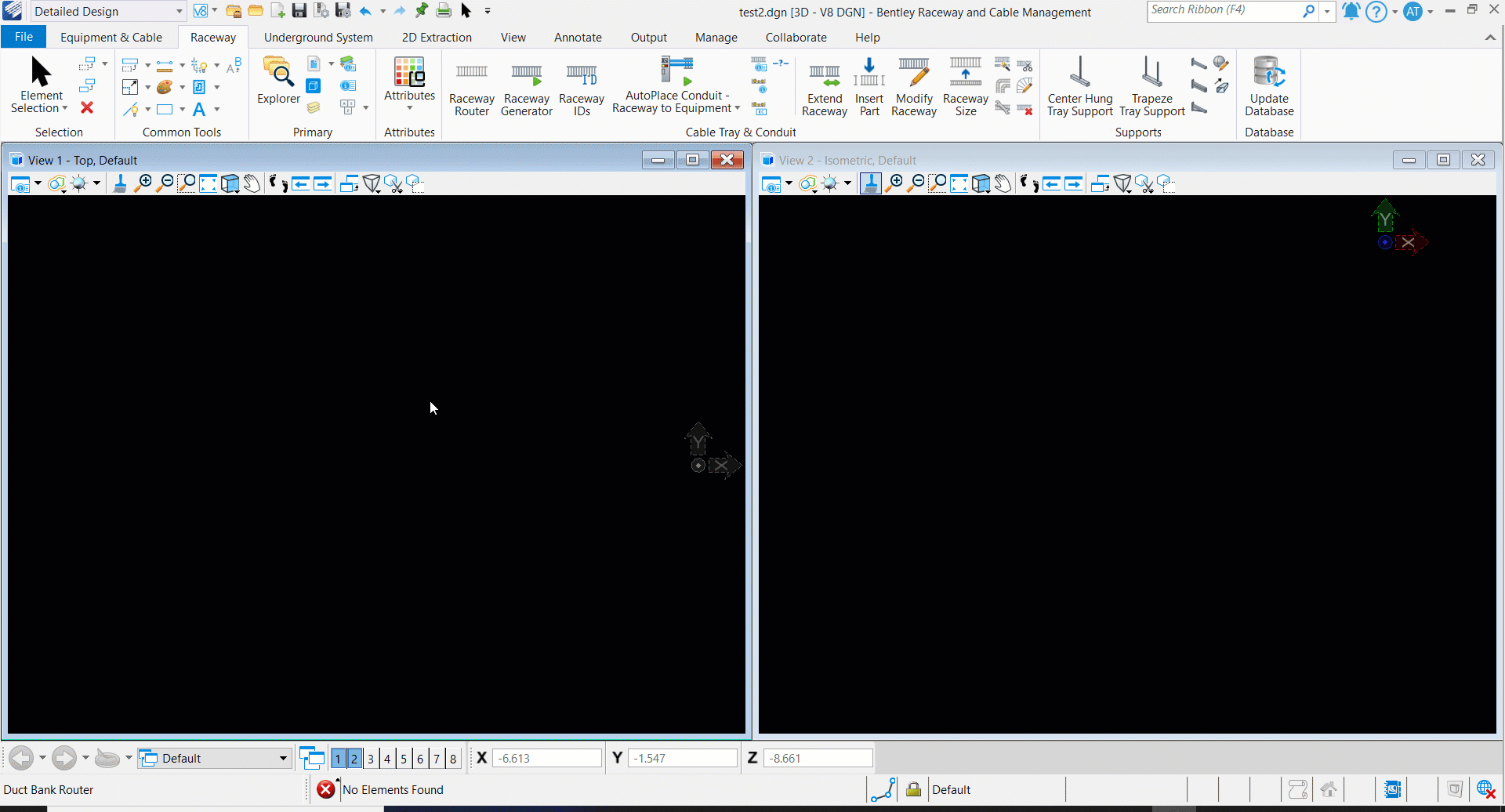

Support for routing underground cables
You can now use the Ductbank Router to generate underground Cable Routes without conduit. In this way you can perform cable routing underground without actual conduit.
Cable routing to a Cable Route will now route to the nearest perpendicular connection along the cable route rather than being forced to enter at one end or the other of the route as is done for conduit.

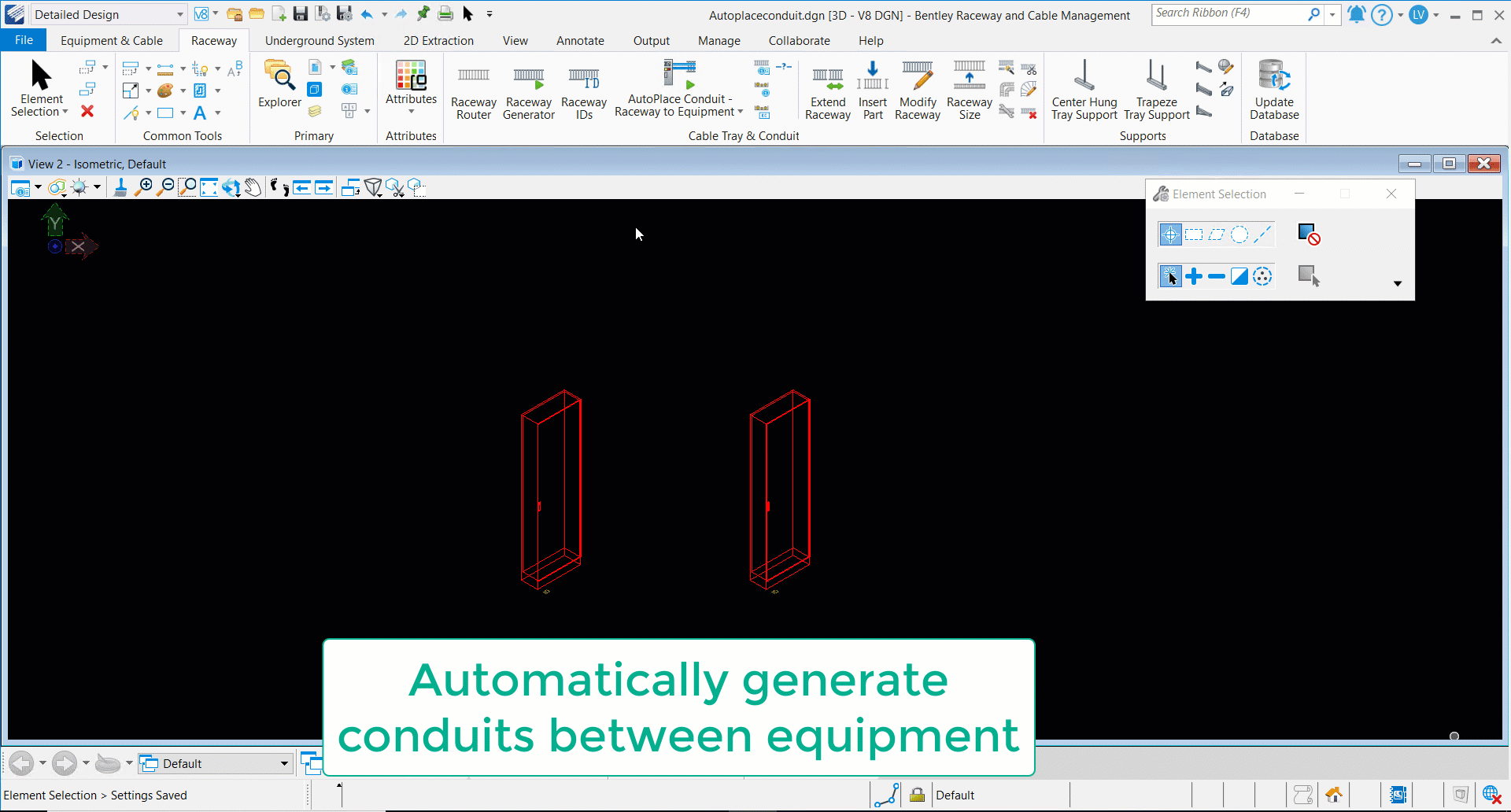

Automatically Generate Conduits between Equipment
The Auto Place Conduit tools have been expanded to provide an additional option for automatically generating conduits from one equipment to another.  The original tool has now been renamed to clarify the distinction between the two options that are now available:
  • AutoPlace Conduit - Raceway to Equipment
  • AutoPlace Conduit - Equipment to Equipment

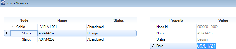

Editable Cable Status Date/Time
You can now manually set the date/time for any change in the cable status in the event that you need to adjust it.
You can also enter the date in any of the Windows supported formats as shown below:

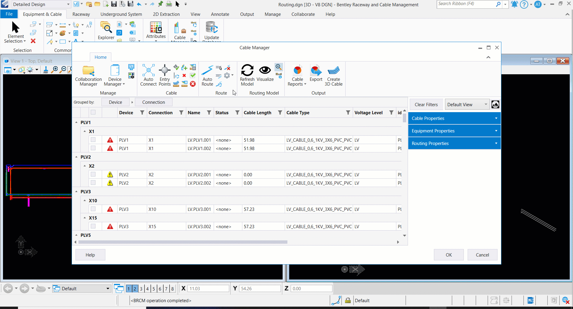

Faster Display of Cable Routing Results
After performing cable routing the results are now loaded and displayed in the Cable Manager much faster than in previous versions.

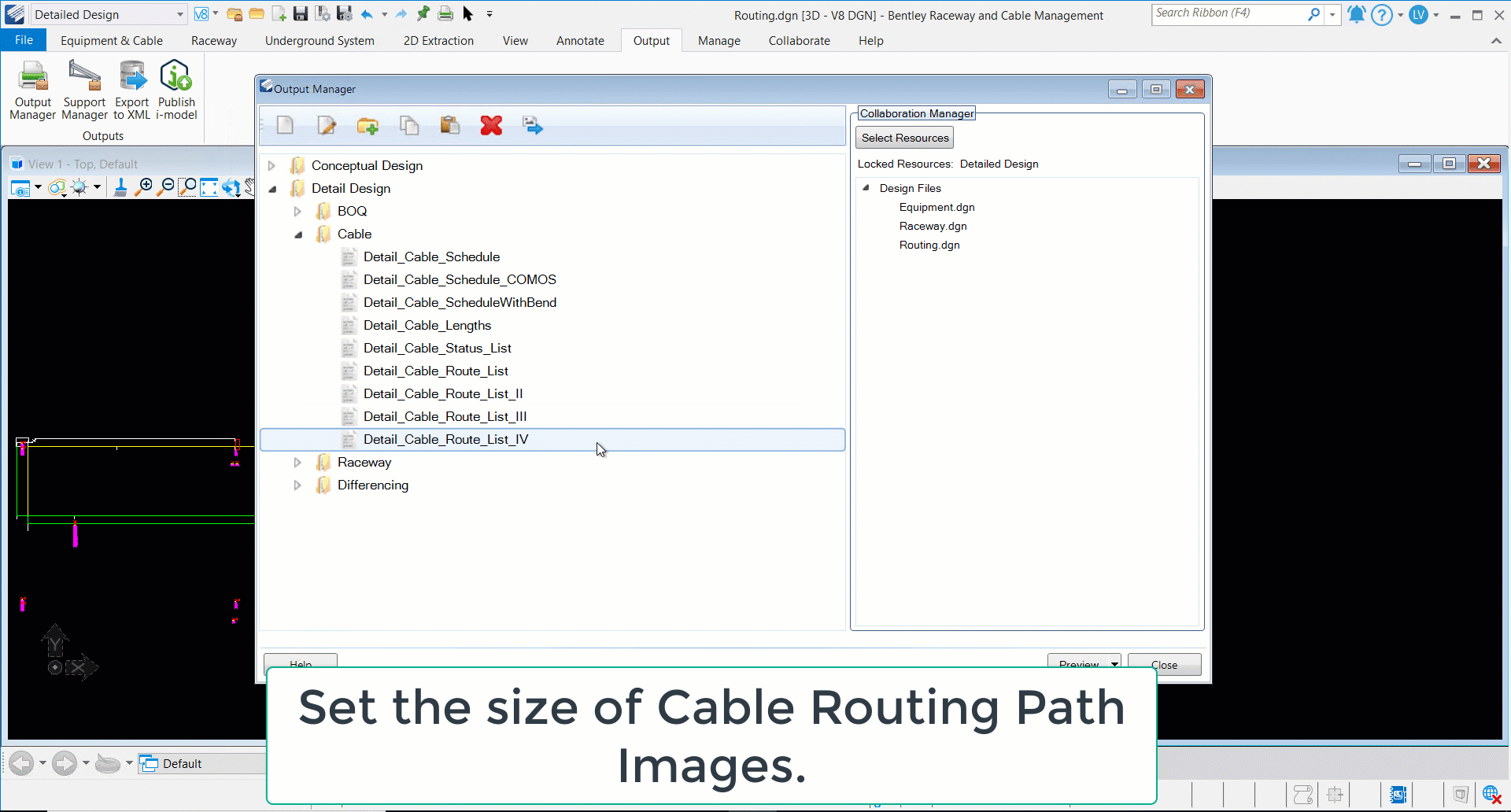

Reporting Enhancements
  • When using the Output Manager to produce a Detail_Cable_Route_List_IV report you can now set the size of the images when using the Export Images button.
  • The PCODE field was enlarged in the default BOM report so that it can fully display the part numbers.
