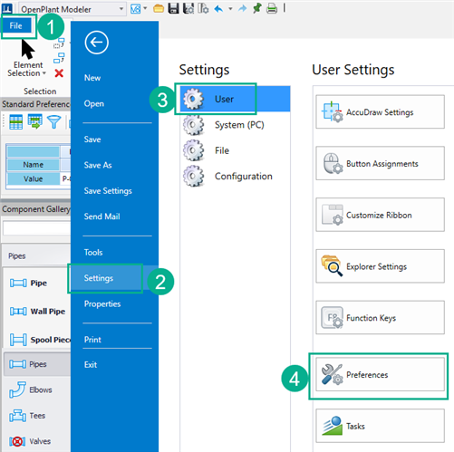

  1. Launch OpenPlant Modeler & open any desired file.
  2. From File > Settings > User, click on Preferences as shown

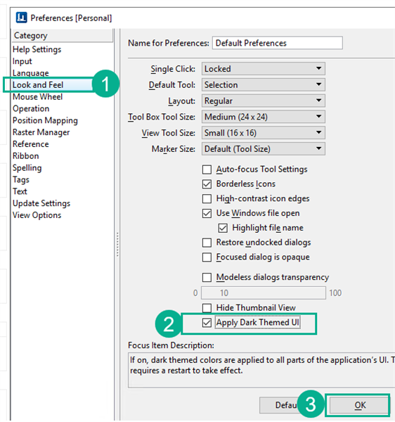

  3. From Look & Feel, Check on the Apply Dark Theme & click ok as shown

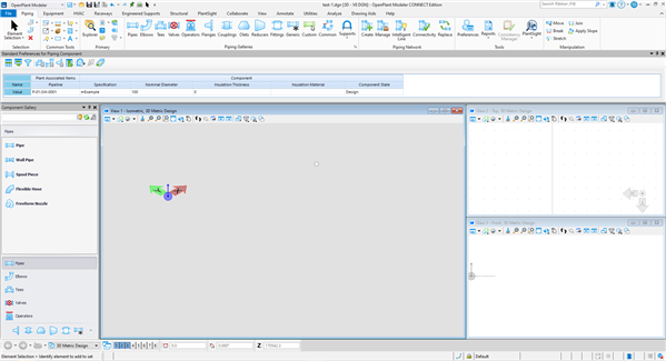

  4. Notice that, dark theme is now applied to the interface as shown
