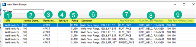

In OpenPlant Modeler CONNECT Edition, while placing a component, it needs to be selected from the spec grid if more than one record is available. In that grid, the sequence of properties is set by default as shown
For Weld Neck Flange the sequence is
Name > Nominal Diameter > Manufacturer > Schedule > Rating > Description > Fluid Port Facing > Fluid Port End Prepe > & So on...

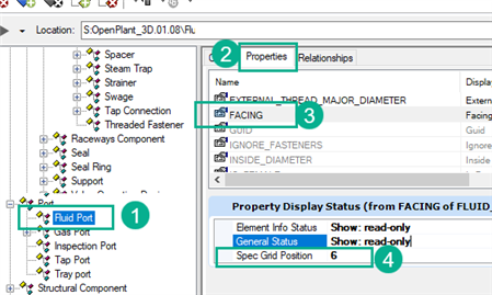

  7. Now, to set the position of Fluid Port class > Look for Facing & set the value to 6 as shown

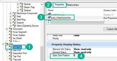

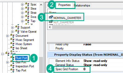

  8. Also, to disable the Fluid port End Preparation & Nominal Diameter, set the values to 0 as shown

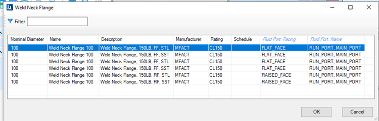

  10. Verify the results as shown
    Notice that, the desired sequence is achieved. Nominal Diameter > Name > Description > Manufacturer > Fluid Port Facing & disable the Fluid Port End Preparation & Nominal Diameter.

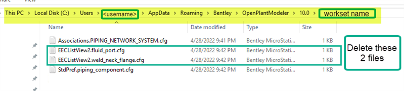

Note: If in case relaunching the OpenPlant Modeler didn't reflect back the results. please delete the 2 files from folder as shown, the path of which is given below
C:\Users\<Username>\AppData\Roaming\Bentley\OpenPlantModeler\10.0\<Workset Name >  Refer to the attached image below.
